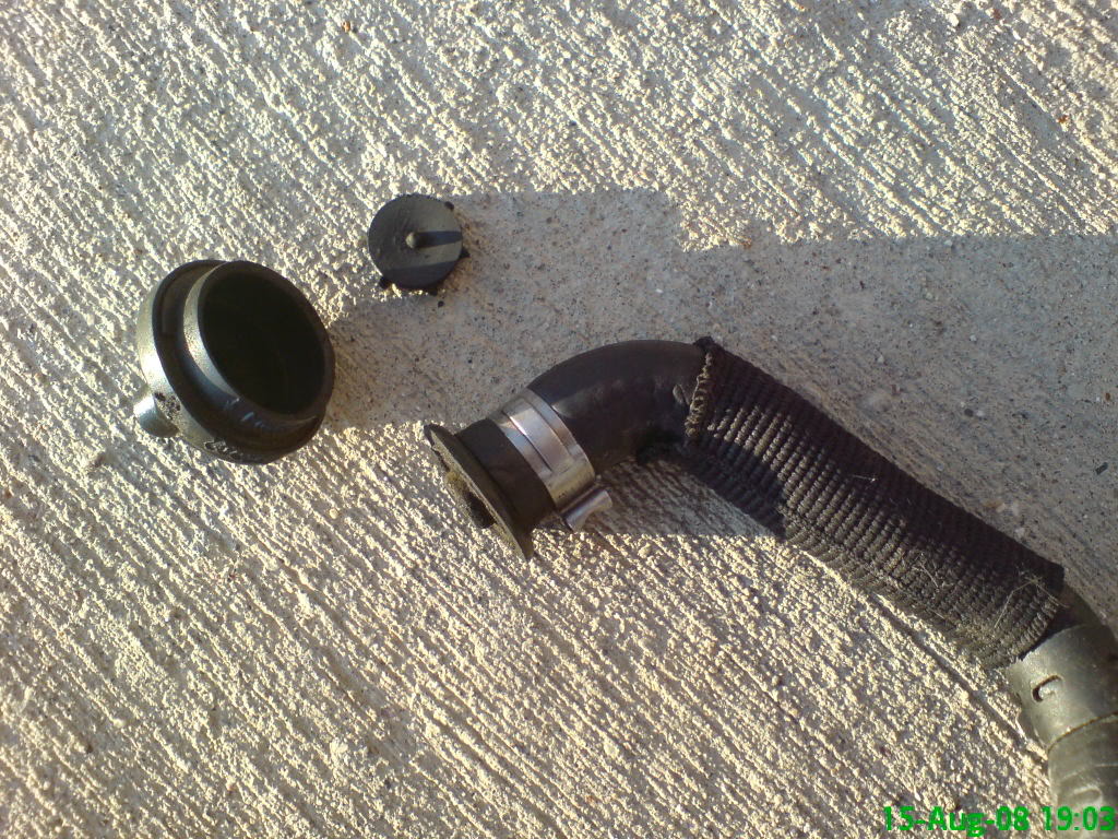

this part?

Originally Posted by audiprotein
this part?
yup that looks like it, although mine broke off at one of the nipples

thats a common thing that brakes
