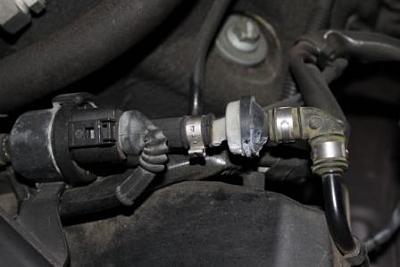

Here is a picture of the EVAP hoses. It looks like it may be bad...

thats a check valve, they go bad all the time but wouldnt cause those problems.

Default In-line check valve and EVAP purge valve
Originally Posted by A4Maine-iac
Looks like your DV is going or gone. Get a new one. I had same issue with a BOV. So that would be your best bet. Easy fix. Get a Forge DV or similar.
So I replaced both of these (in photo), and it is still idling hard. It sounds better and I hear the purge valve go off now... not before. I still get these code though.
