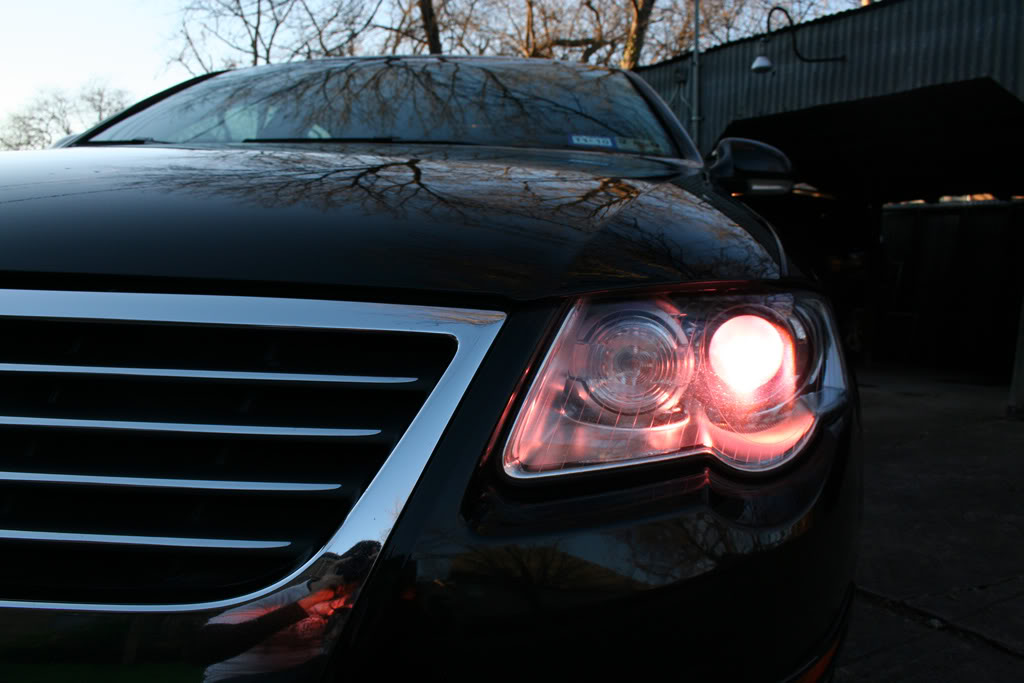

Yep, need new ones...

^^ hey a texas passat! wheres that from?

alright alright, i meant which dealer
