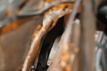

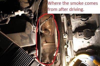

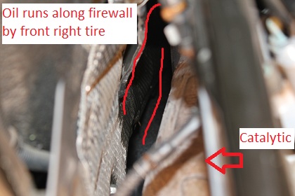

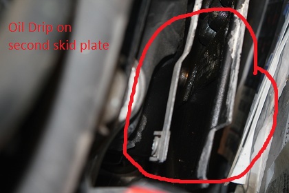

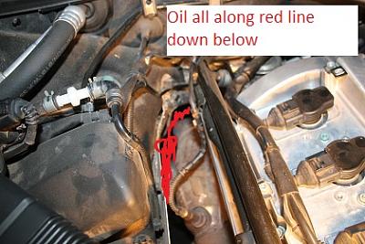

Hello all, I have been looking hard on the internet for people with the same problem as me and so far I have found very few. I have a 2002 audi a4 1.8t with a oil leak/spray coming from the passanger side close to the front right tire. I did a coolant flange job not too long ago as well as coil pack replacement and since then I smell what seems to be burning oil after a moderate drive. Sometimes I would see white smoke coming from the gap between heat shield and air box above the cat. Less than days ago I stopped driving after about 5 miles and much more smoke was coming from the engine so much so it was coming out the sides of the hood. Later that day I noticed two big puddles of oil under passenger side control arm. I think my engine also eats oil because I have to top off the oil quite often. There was also a line of oil drops from my garage and down the street. The oil seemed to run down the heat wall and on to the 2nd farthest skid plate ( facing front of car) it also apears to leak only when running because there are no drips now. I have felt around the gasket cover and cam valve for an signs of fresh oil or pinching and didnt see any, pics below. Any help would be greatly appreciated!

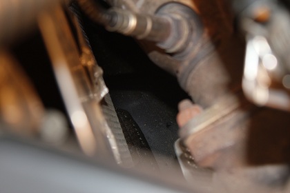

More Pics

can you see the oil feed lines for the turbo? thats on the passengers side. can you get a picture of the back corner of the head and valve cover? or jack the car up and take the skid plate off and get a picture from under too if possible.

i say its your vavle cover gasket. . .

if its the rack leaking just look through the wheel wells, you will be able to see the rack boots. the rack is mounted up high so it will be easy to see through the wheel well. the power steering fluid for that car should be green in color. how many quarts of engine oil are you going through in a week? and how much power steering fluid are you going through. if its engine oil thats causing your problem the smoke should be a bluish color, but the power steering fluid is a mineral oil and gives off white smoke when it burns. let me know what you find. if your lucky pa4ul is right and its just a valve cover gasket lord knows almost every one i have ever worked on has had leaking valve cover gaskets lol.

i second the valve cover gasket. its the most common issue and typically most noticeable by the cat.
the smoke also makes sense if its a bad leak, oil dripping on to a hot catalytic converter and then burning off
