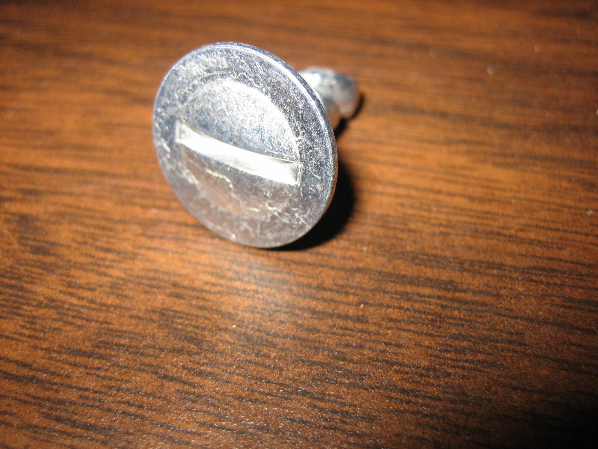

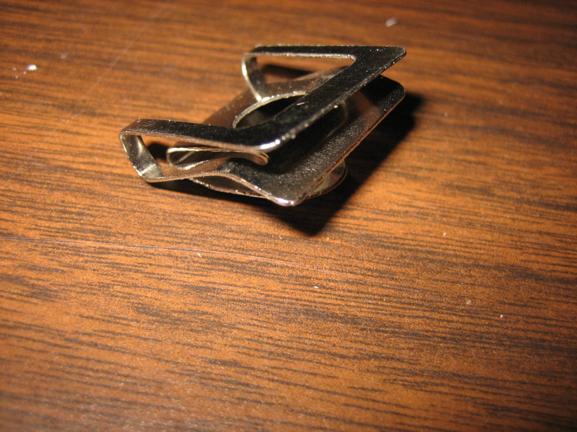

Belly Pan Screws and Speed washer (nut)
Just in case someone is trying to locate:
I stock the quarter turn screws as well as the matching spring nut/washer.

Do you still those photos from 2013.
Been having similar issues on D3 A8L, resorted to using industrial zip ties but if you need to take off to do oil change you have replace zip ties. I'm installing new swaybar brackets, fronts struts and tie rod bushings tomorrow. Ordered new hard plastic belly pan from UK too.
Hope you have the photos.
thx in advance.
