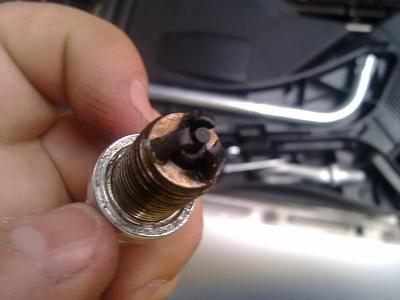

i have a picture of that spark plug. I'll try to post it. It's black but not sticky...

That plug looks gas fouled. Being that this is the only cylinder with the problem, make sure the wire and/or coil firing that plug is up to spec. Otherwise the injector may be leaking or stuck open, requiring a cleaning or replacement. However, before changing things make sure the compression in that cylinder is up to spec.

thats not even the right plug............. Your supposed to have single prong. These "performance" plugs have no real advantage unless your into professional racing and tuning.
The engine is designed to run best with what it comes with from the factory, including plugs. By Audi plugs and replace them. If compression is good you and the plugs don't fix it, you probably have a bad injector

These are Audi NGK plugs. Guy in official Audi service put them, a month ago instead of original ones, that were faulty. But they are on vacation now, so I have to wait, or try with different mechanic.
