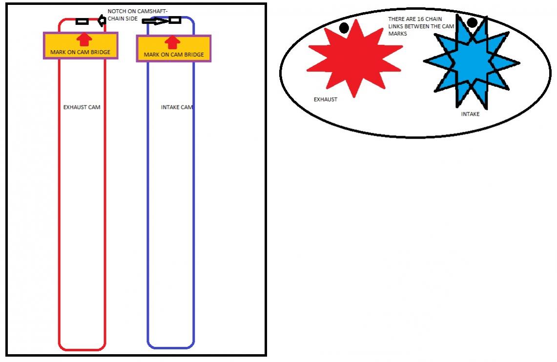

now i get a code for intake cam over advanced. hence why i checked and re did the cam timing on the chain side. i still got the code so i replaced the tensioner again and checked timing. there is 16 chain links between the two sprockets and the marks on the cam sprocket as shown in the picture.
sorry for the crude art work but its the only way i could describe this. the intake cam as you can see in the picture is slightly to the right of the arrow after i remove the tensioner tool. i turned the engine over by hand twice and rechecked it, timing was still as it was. so i started it up, this time the car sounded normal during the initial start and drove normal.(before it sounded like it was misfiring the first 2 times i did the tensioner and timing).

but looking at where the intake cam sits in relation to the exhaust cam timing mark, what are the chances that the chain is infact stretched?

Not trying to be rude since you did the timing 3 times...but the engine IS at TDC when you are aligning the chain links and the cams correct? Crank is lined up TDC? How did you check the timing? Looking at your 1st pick, the notches aren't right on, I'm assuming that's the drawing, but mine weren't either a couple of times and I had no issues-but after I hand cranked it a few times, the notches lined up pretty much dead center.....when you finished putting the tensioner in, did you hand crank the engine (do a full rotation) a few times by hand and watch the tensioner and THEN check and count the links again (if you made marks they won't be lined up an anymore, but you still should have 16 links and be DEAD on). Once re-assembled, you SHOULD hand crank it a few times, get it back to TDC and then count the links again.

Here's a link for the DIY on the B5 for the tensioner...photos are a little better to look at (not trying to offend your drawings)...if you look at them, are yours lined up like that?
