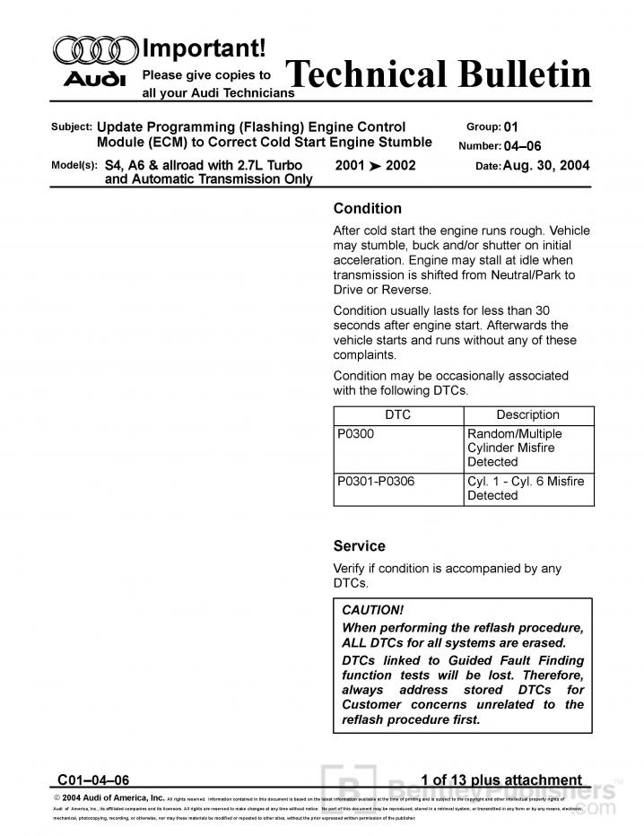

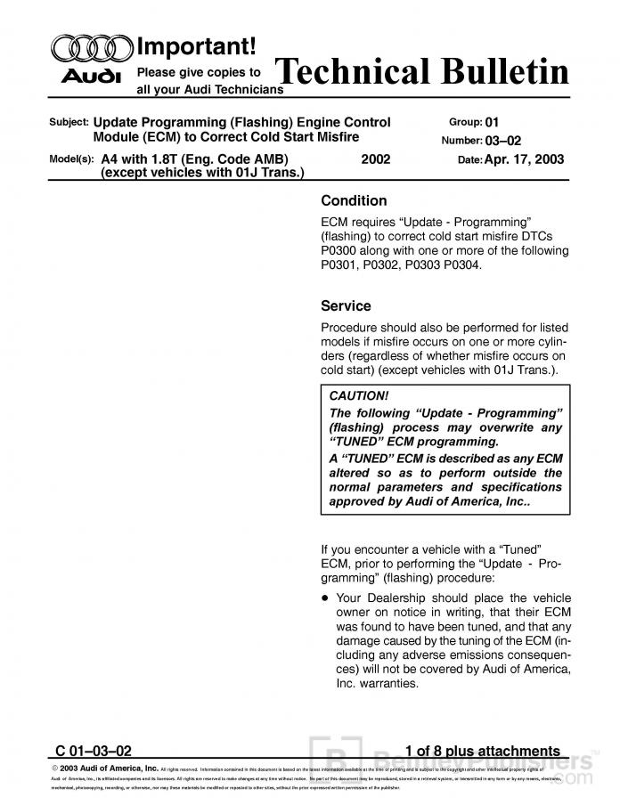

here they are, neither of them are for my engine but maybe thats why the dealership didn't flash it, also is it illegal to post these?
Attached Thumbnails Timing belt change causes misfires-tsb1-1.jpg   Timing belt change causes misfires-tsb2-1.jpg

Yeah, its public information so it can be posted. Those are old TSB's for the 1.8T and 2.7T twin turbo. So they still haven't made a flash for the 3.0L huh...... If thats the case you may need to find a really good mechanic that knows audi's. Or you could ask the dealer to have the shop forman look at it for you, which should be the most experienced tech in the shop.
