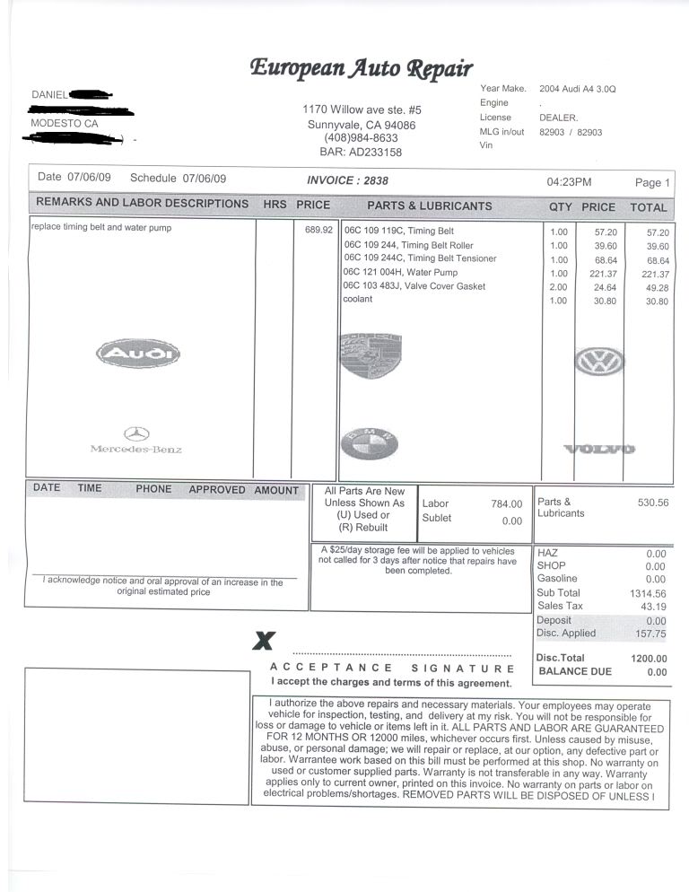

I just had mine done and it doesn't specify and "eccentric roller" although I would like to know what it is. I got a copy of the receipt here check it out:
Then again the guys there seemed to just write down a unit of 1 for the coolant. I don't if all that stuff that you have on you parts is on mine or not, now that I see it the thermostat wasn't on mine... bummer... hope it doesn't fail.

I think eccentric roller is the relay roller. BTW, your image doesn't show up.

Both show up here..
OP, yes, Seems pretty complete to me. Get it for less than Dan and you'd really be doing good

Both images show up now. I guess my office's firewall blocked it when I viewed it this afternoon.
I am getting pretty much the same price as Dan had; $1320 parts and labor. But, I don't have the discount though... Anyway, since there are few more things in my package, I called it even. Plus, I can't really find anywhere cheaper than that for the same deal in NY/NJ area. Some places are cheaper but include less components.
Old Jul 9, 2009 | 02:08 AM
Dan1969's Avatar
Joined: May 2009
Posts: 1,682
From: South Korea
The only reason why he gave me the discount is because I communicated with him in the "bro" language and used words like "****" and "f#ck" and stuff like that... lol nah I called around to get estimates and he gave me the price over the phone when I dropped off my car he told me that he was gonna respect the price he gave me. Even like that I ended up staying on a hotel for 2 nights and was a whole lot cheaper than having it done by the dealer.
