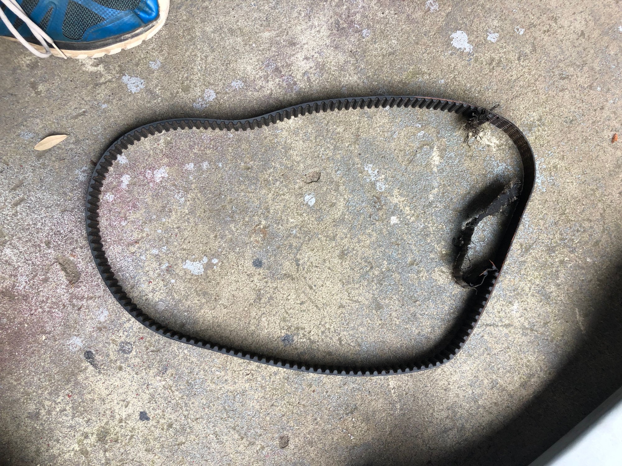

· Pulled the front forward (per some good Youtube videos) and got the lower timing cover section off and the teeth had been stripped from a section of the timing belt. I think it was near the intake sprocket or the water pump pulley. Stupid me didn’t make note and write it down.

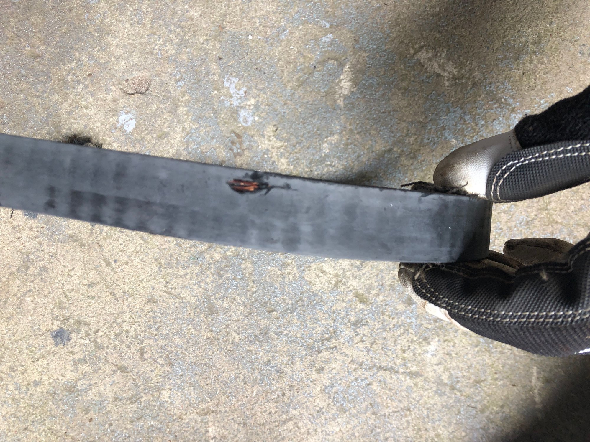

I’m thinking about just putting a new timing belt on, setting the timing, reassembling and saying a prayer but before I do that I wanted to see if any of you experienced Audi guys, of which I am not, had any ideas of why the teeth would strip off the timing belt like it has. I’d hate to put it all back together and have it happen again in another 100 miles.
Any advice or any pointing out if I’ve done something dumb in the list above would be greatly appreciated. I’ve included some pictures of the belt and can add pictures of other components if needed. Thanks in advance for any feedback.
