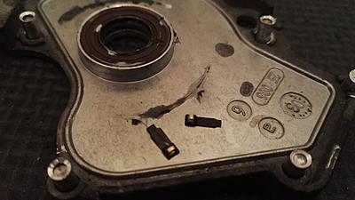

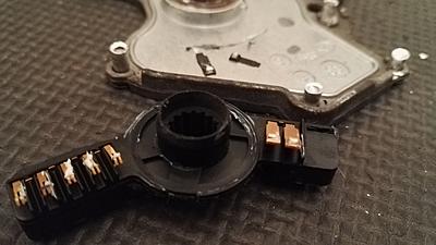

Post mortem examination on transmission range sensor p0706 F125
Here's what you'll find when the fault code states "mechanical failure".
In the following photos you can see that two of the contacts have broken off, anyone who has owned a slot car racing set will recognise them, same thing as the cars use to get power from the track.
There is also noticeable charring of the terminals on the wiring, probably as a result of the contacts shorting but also possibly due to ingress of moisture, which could be the cause of the whole deterioration of the sensor unit.
Note that the two contacts which have broken are the two that sit lowest (nearest the road) and therefore would be submerged if water built up inside the unit.
