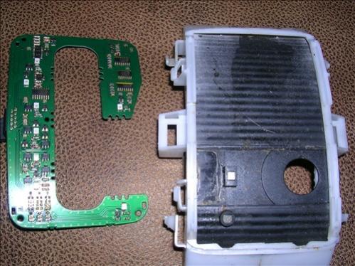

So I took apart the shifter, it looks a little different, but came apart the same way. I was expecting to find the magnets gone, but they are still there. I'm wondering if it could be something in the computer? Would this cause any codes to come up?

What's that rubber part from you shifted called (the second pic in ur thumbnails), mine seems to be messed up it's almost tearing and I feel resistance putting it into park
