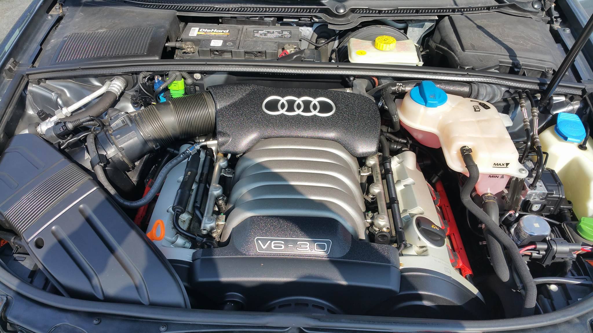

Hi there, I'm new to Audi and looking at buying a 2005 audi a4 3.0 quattro automatic. While at the dealership, I noticed a leak coming from this hose. Didn't seem like a bad leak, but I noticed fresh liquid on the engine directly below it and a drop sitting on the bottom of the hose itself.
Is this normal? What is this hose for (cant find it anywhere)?
Also, as far as the engine is concerned, it seemed very sound, but when I went from a full stop to full gas, I noticed a small amount of white smoke come out the back. It didn't do it again during the test drive, only the first time.
Is that normal for these cars? Assuming it's been sitting for a bit.

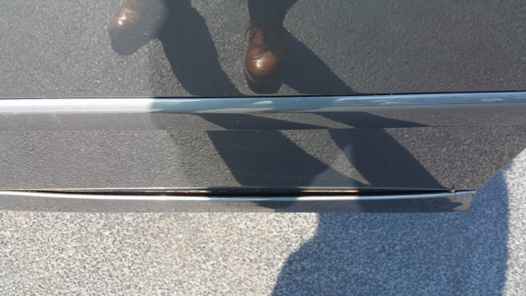

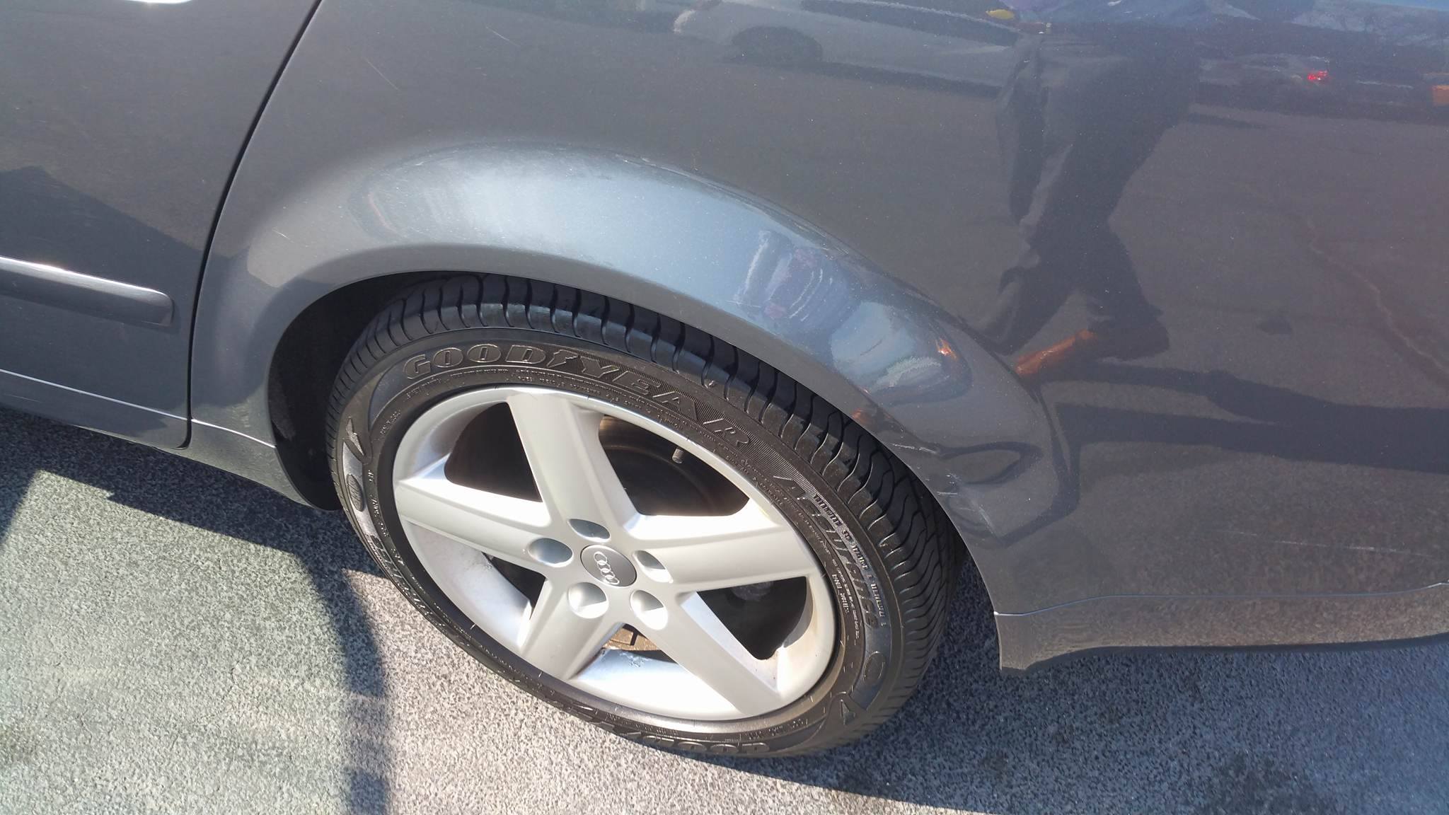

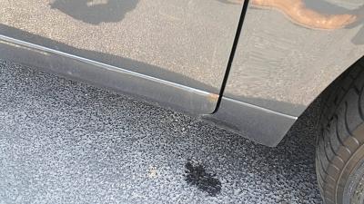

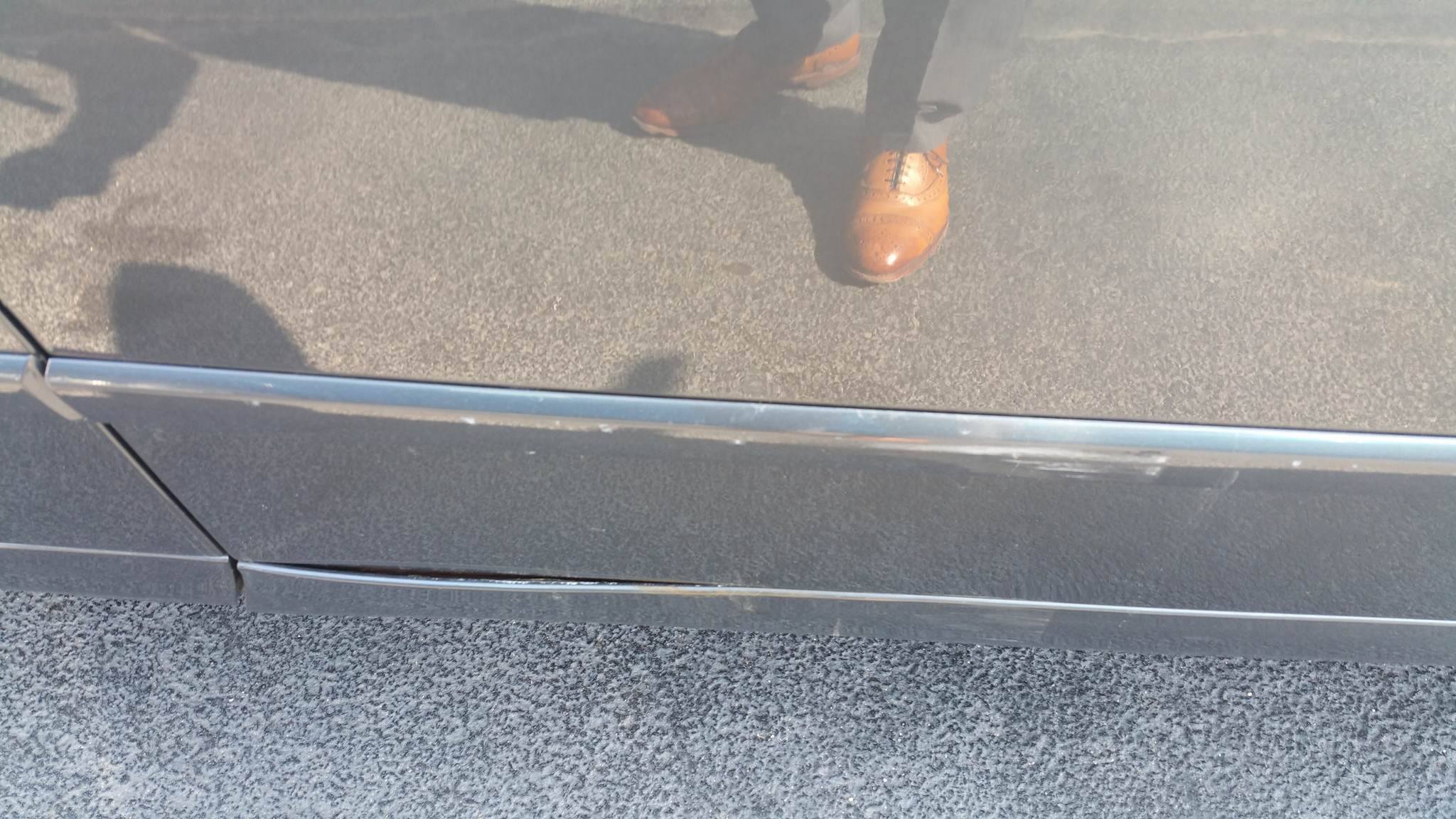

Finally, given it's an 05 with 63k miles, and somewhat damaged cosmetically, I would imagine it sat outside for some time. As I looked into the damage, I noticed a good amount of rust under bottom of the door paneling. Does this look like a huge issue, or are these parts easy to come by? Would I be in the same price range if I had them use the Sline side panels?

I've got an '05 3.0, with over 150K miles. That hose is the high-pressure line to the power steering. A minor leak can be ignored for a while, unless it gets worse. The "white smoke" hopefully was steam being blown out. A car on a dealer lot likely gets started and idled a lot, leaving water in the exhaust system.
