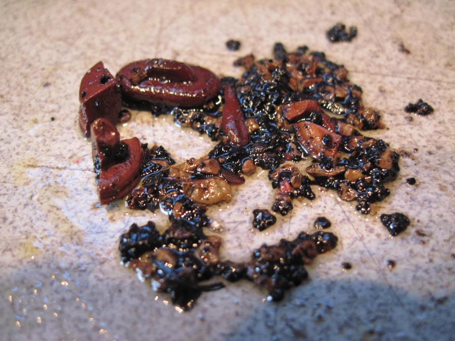

It was the infamous plugged oil pic up screen.
Any idea what thes big chunks are?
I pulled and cleaned the oilpan and screen and these were in the pickup.
Good news is, no more noise or codes!

Old Nov 14, 2011 | 11:42 AM
jdahlen24's Avatar
Joined: Nov 2010
Posts: 695
From: Rochester, MN
Holy crap, looks like someone dropped a plastic plug into the crankcase. Not good!
Old Nov 14, 2011 | 12:41 PM
02A6Beau's Avatar
Joined: Jan 2010
Posts: 2,945
From: Western MD USA
yuck!
gravel? the red thingy is definitely something that should not be in there...
wow...
just wow
Old Nov 14, 2011 | 01:28 PM
GCMARK's Avatar
Joined: Sep 2011
Posts: 17
Nice huh?
I'm convinced the wonderful couple who sold the car to me were told to get rid of it, being it had just had the timing belt, water pump/thermostat and coilpacks AND A BIG FILTER done.
The "rocks" are sludge and coking from the oilpan.
