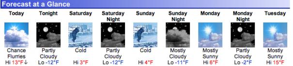

With the temps up go ahead and try to run the heat manually. Maybe set it to 80 and let it run to see if it does in fact switch to cool or if it stay on then it's narrowed to a sensor either acting up or malfunctioning.
My forecast is attached....
