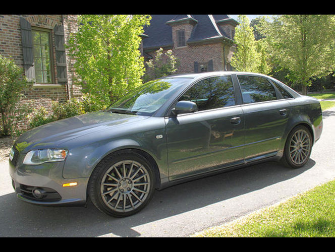

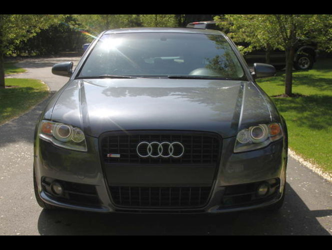

Hi Folks,
I am planning to buy a used 2008 A4. The overall history of the car is good and after the pre-inspection the dealership quoted me this (rough estimates):
75.000 mile service : $400
T-Belt: $1500
Brake Vac Pump: $550 (leaking some oil)
Valve Cover Gasket: $250 (leaking some oil)
Tires: $1200 (tires are very worn according to dealer)
Lower Engine Cover: $400 (dealer told me it wasn't a big issue)
The car has 79,000 miles and seems to drive perfectly. I will be getting all of these issues serviced, but want to be cost-effective. I figured, I could buy the tires on Tirerack for 700 dollars. Will Continental All-season tires be sufficient on a quattro (summer-winter)?
Would it be smart to get the other issues fixed somewhere else? I am unable to fix it myself. What are the usual price points for these items?
Are these usual issues around 80k miles?
It is lacking an Audi Navigation CD/Manuals. Are these deal breakers? Where could I get a navigation cd?
Any insights about this car or about your overall A4 experience would be greatly appreciated.
Thank you so much.

One thing you left out is the price. With worn tires and a few oil leaks, you should be getting this car for a steal. You're looking at $1200-1500 in service/maintenance RIGHT AWAY, so factor that into the price you negotiate.
It does look nice from the pics.
