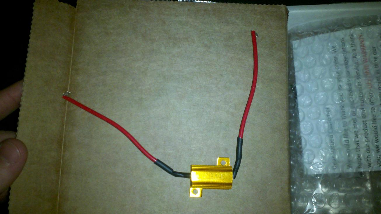

stupid question: i finally ordered the led light kit from krautoparts but im confused about the box with the red wires. i tried emailing but they are having site problems. can you tell me what its for and how to install it?

Box with red wires? I didn't have anything like that in my kit- granted mine was semi-customized due to already having the plate lights; thus the only thing that immediately comes to mind is that maybe this box you speak of has something to do with that? Could you maybe post a pic and I'll see if its anything I've seen before that I might be able to shed more light on? Cuz yea, all I got was a bubble wrap envelope full of bulbs- no boxes or wires or anything like that...

Wait! I do know (I think) what they are. Sounds like resistors. Did you *just* get the interior kit, or did you get some for the DRLs and or reverse lights as well?

I got the interior kit only. I kinda assumed it was for the license plate lights so it doesn't throw a code but I'm still not sure how to put it on. When you did your plate lights did you have to do somethin like that? Ill put up a pic when I get on my compy later.

here is a pic of the box and wires

Yep, that's a resistor. And yes it is for the plate bulbs. The thing is, I can't help you with that one. I have no idea how to wire that in there, unfortunately. It is to keep the CANBUS happy and error free, but I didn't have to wire one when I did mine. I got my plate bulbs off eBay (hence mentioning that my order from krautoparts was semi custom due to already having the plate bulbs) that were not *just* bulbs but a full rebuild of the entire bulb assembly- lens and all- that had the resistor built into them already so that they were plug n' play and error free right out of the box. Sure they were a little more costly between it being a whole new bulb assembly plus already wired to be error free, but it was absolutely worth it to avoid having to muck about with wiring to trick the system into thinking everything was okay. I'm pretty sure I've seen in passing a writeup or two about how to wire that resistor in there so I'm sure if you just googled it you could come up with something
