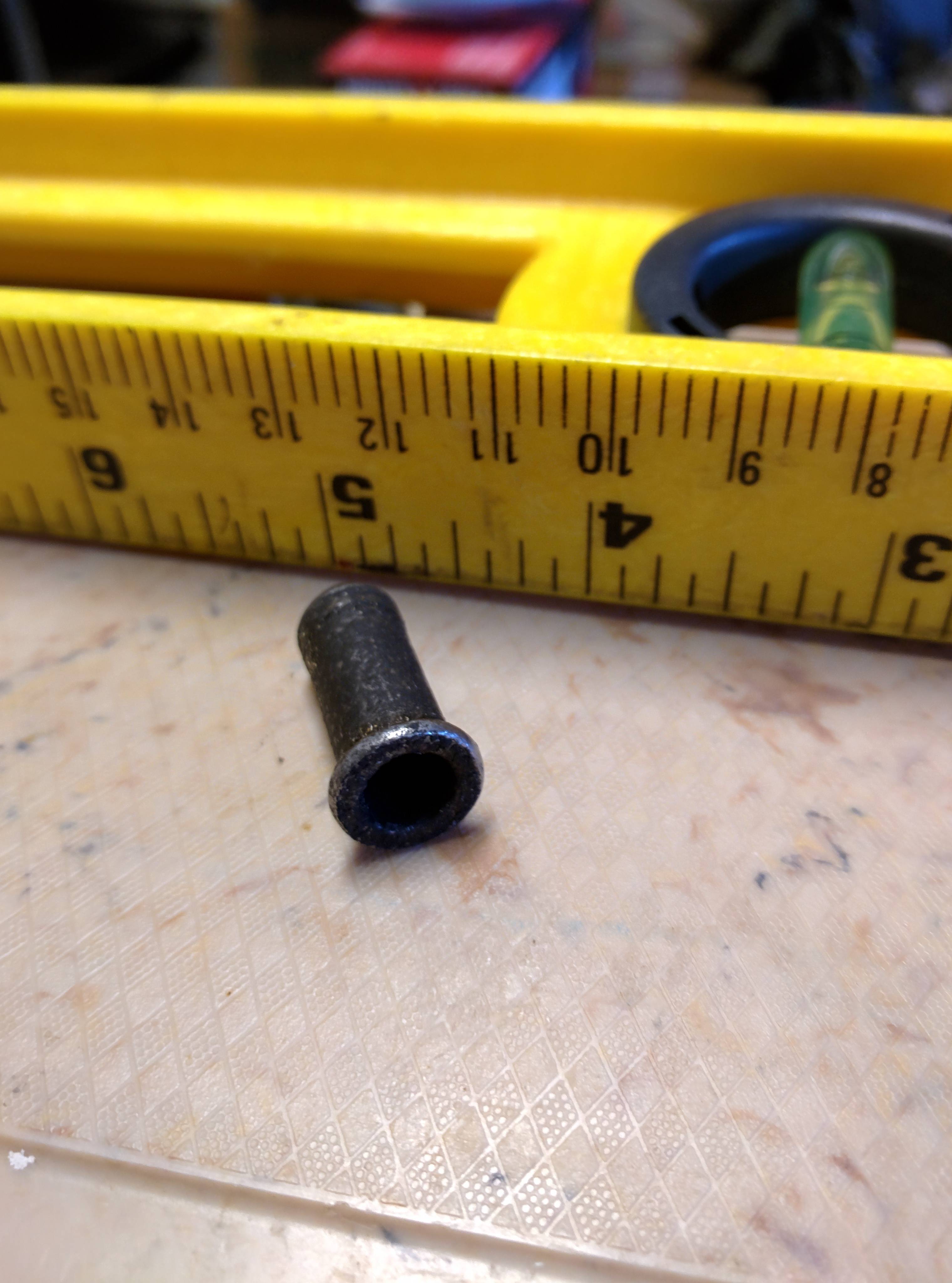

Turns out this was in cyl 2 (on top of the valve). Must have fallen in there while someone was working on it or via the intake manifold?
Is this even a part of the engine on these cars??
After removing the car seems to run fine.

Not sure what that is. If you are close to an Audi (or VW) dealer you might run by there and show it to a mechanic. Odd that it was just sitting in there. I would identify it just to make sure there isn't something missing in your engine now that might cause issues later.
