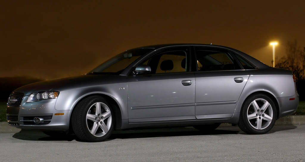

Do you want a 1.5" drop from stock (non-sport suspension) with an increase in performance yet smooth ride on rough roads? Two choices: a good coilover system (i.e Stasis, Koni or Vogtland), OR the Eibach Pro springs and Koni FSD shock combo. The coilovers installed will cost you ~$1400+ while the Eibach/Koni-FSD combo installed was just under $1000 for me.
Since I didn't have a need for a deep 2" or greater drop and didn't want to bother with adjustments, I went the Eibach/Koni-FSD route and absolutely love the ride with just enough lowering for me. No rubbing, no harshness, and it is lower than the harsh factory sport suspension setup. This is post-install:

wow, looks great ! i will look into that asap. I guess even a 1 inch drop would be fine so just need to research it a bit more.

This post was SO helpful Bmeister! I'm looking for a slight drop but comfortable ride these days. Sounds like this setup is what I'm looking for, thanks for including a pic!
