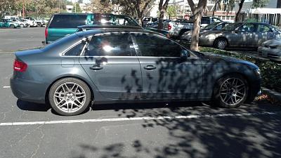

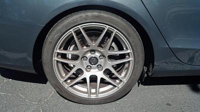

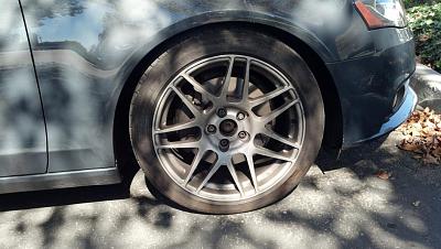

Some pics btw, I like the look thats for sure. Just need to work on that bouncey rebound.

Old Sep 4, 2013 | 10:20 AM
ECS Tuning's Avatar
Sponsor
Joined: Sep 2011
Posts: 7,225
From: Wadsworth OH
Plenty of our employees run coilovers that are not stainless and we go through some pretty harsh winters. They have held up fine. Basically what you need to do is coat the threads in anti-seize. This will protect them from the elements if you ever have to adjust them.
