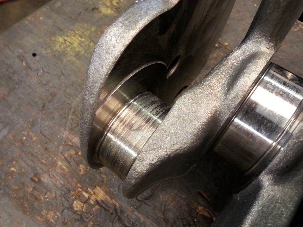

I work at a machine shop that deals with lots of imports, and we had a customer bring in a hurt '09 CAEB crank. All 4 rod bearings were toast. There are currently zero bearings available, OEM or aftermarket, that exist in an undersize, so that means it's either replace the crank or grind, weld and grind again back to standard. Money-wise, the grind/weld/grind thing is what's probably going to happen.

Obligatory gratuitous damage pic
