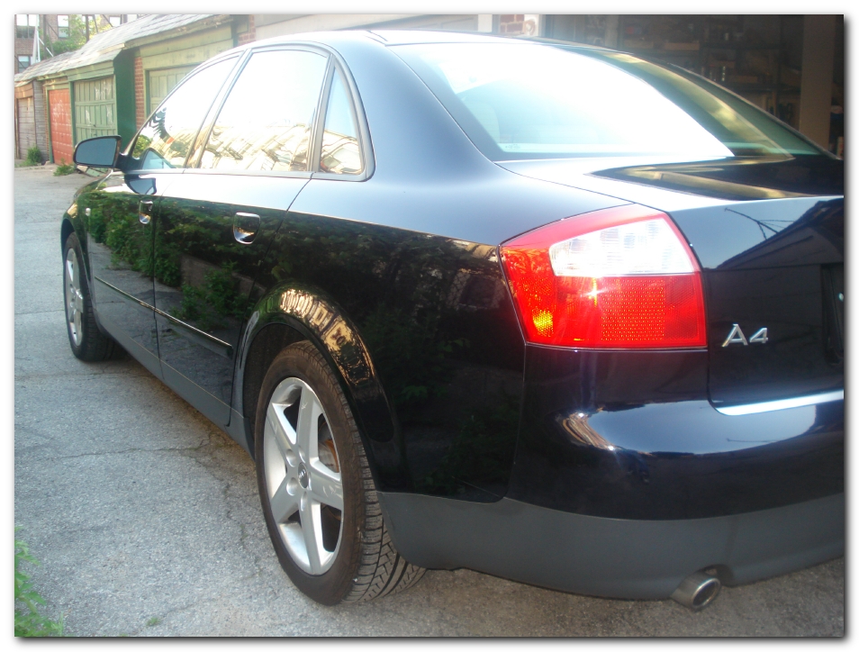

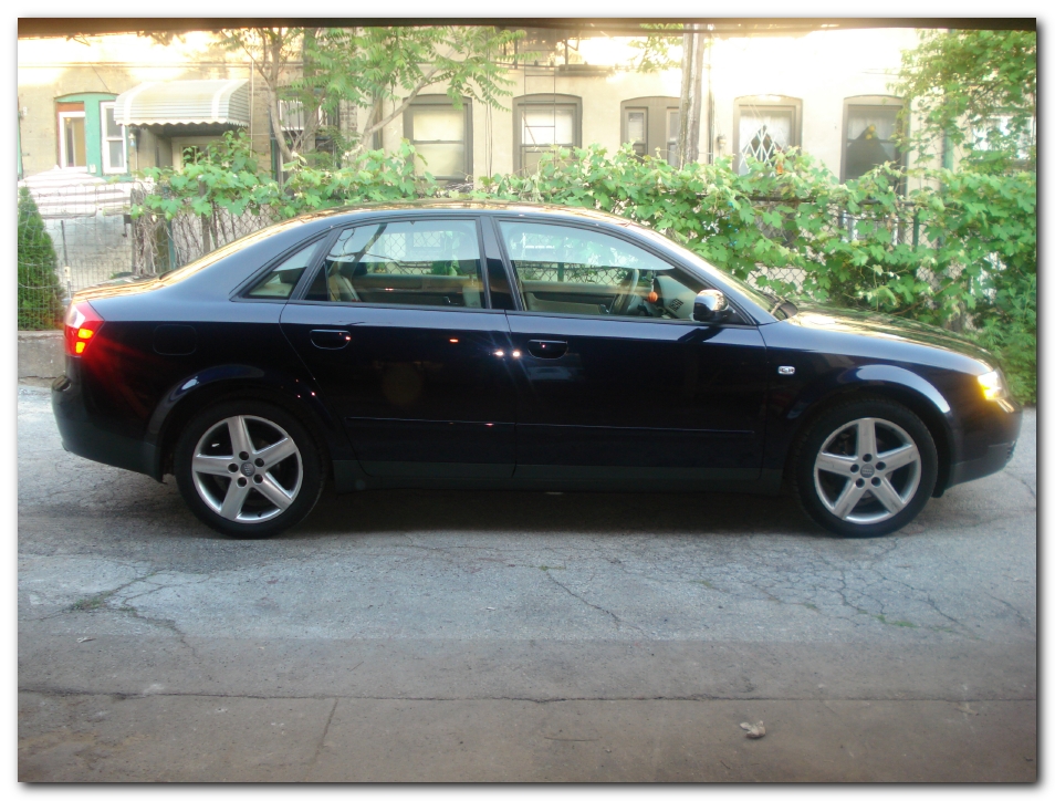

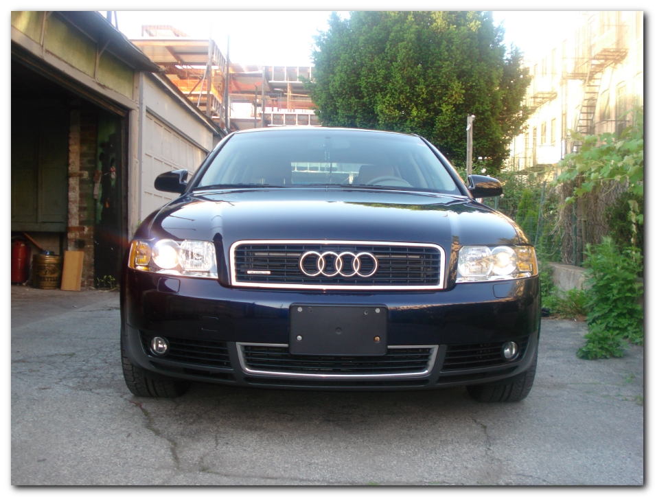

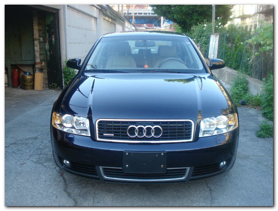

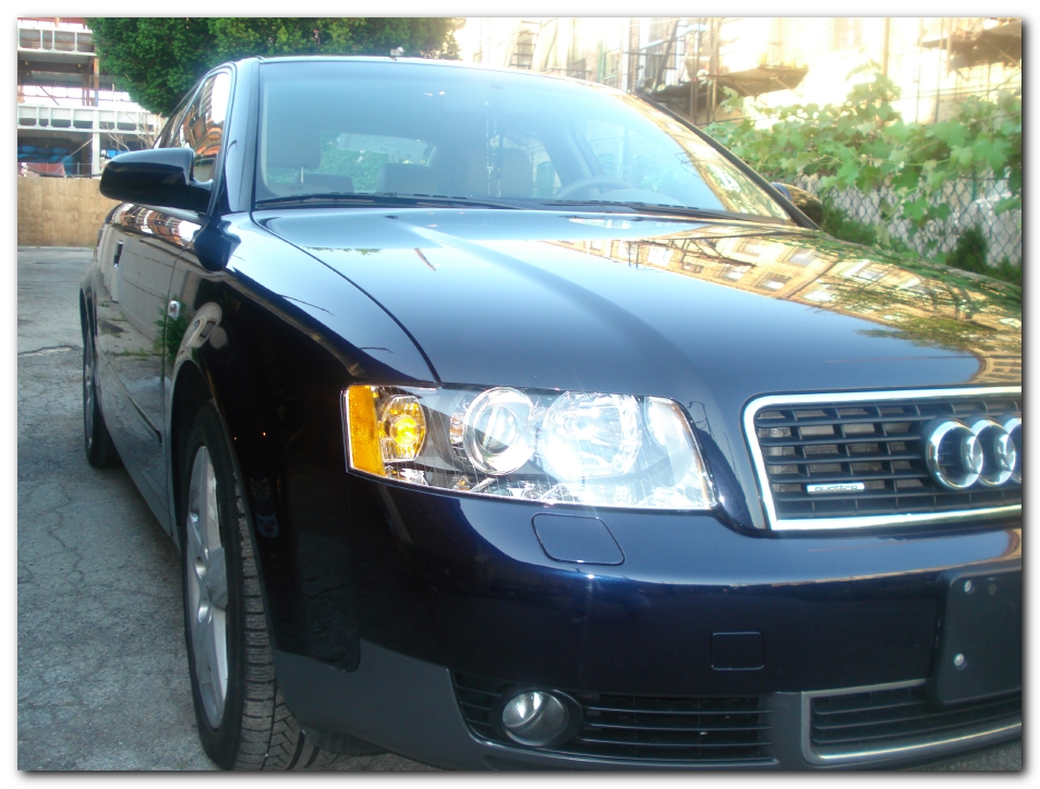

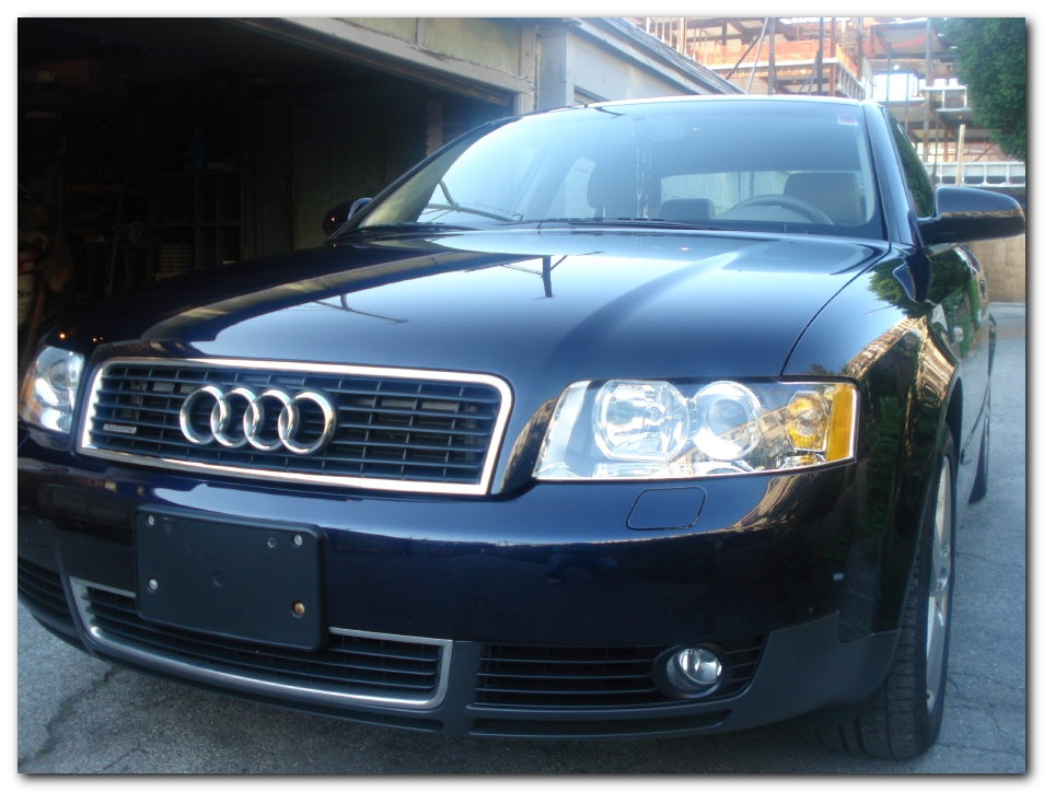

Hey George,

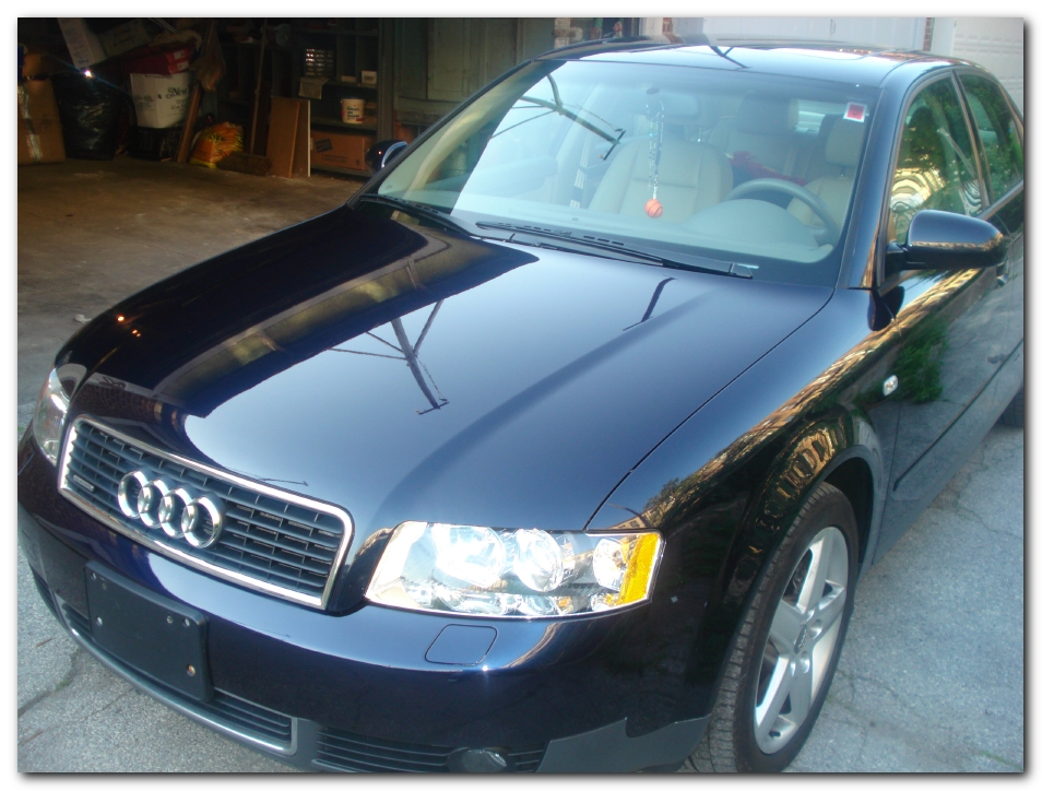

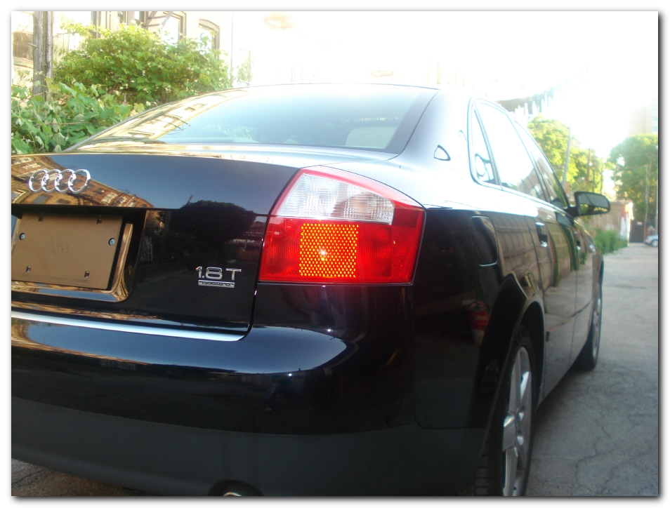

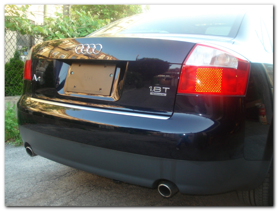

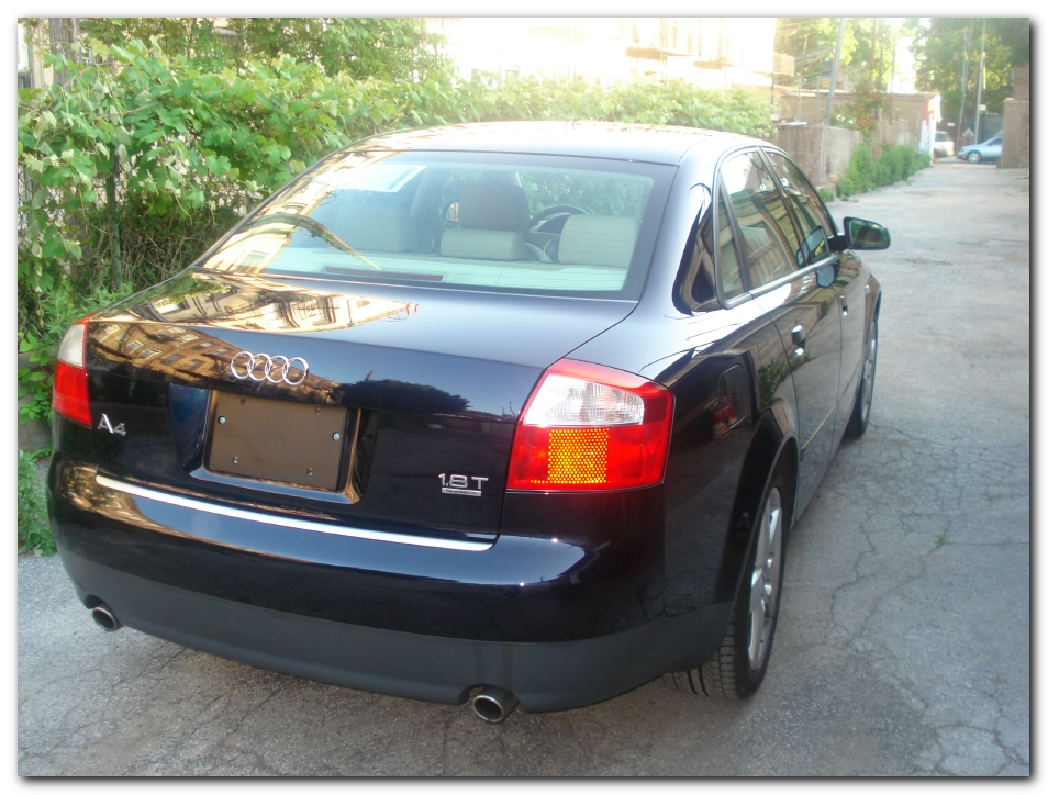

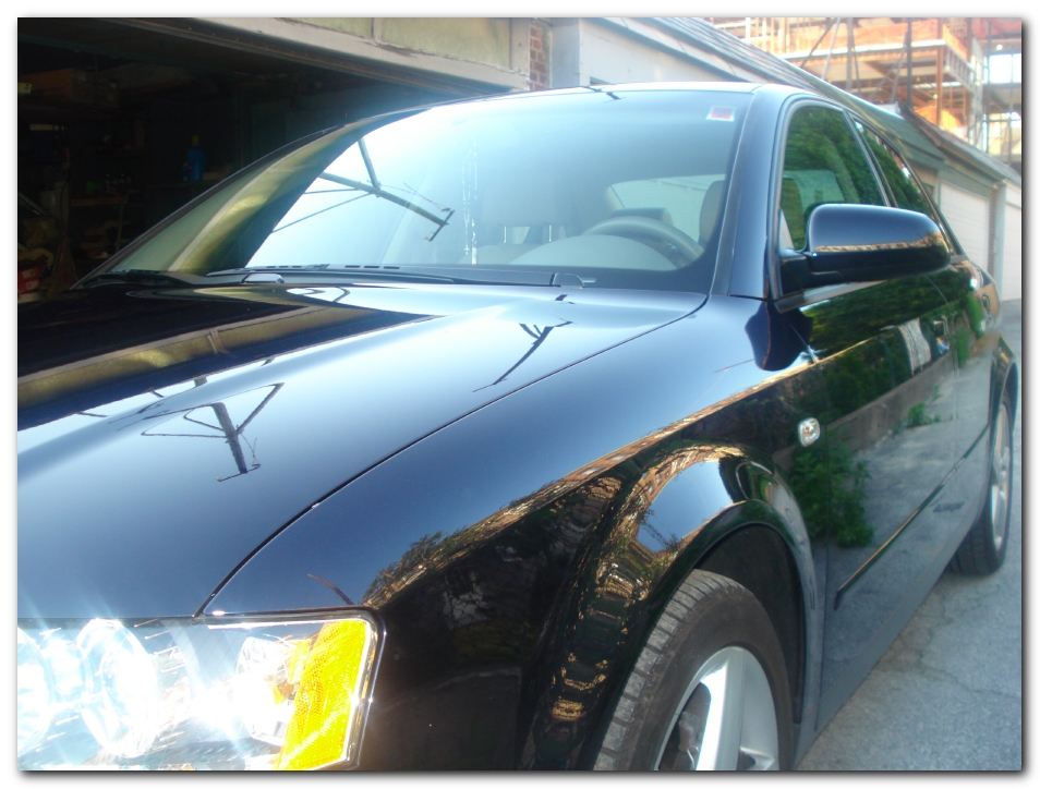

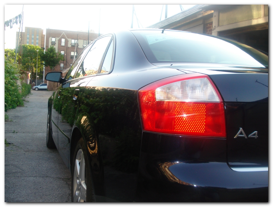

I read your instructions on how to detail and I was eager to detail my newly purchase A4. I was going to be ordering from Detailed Image but wanted to have the products in my hand as I wanted to try our your methods right then and there. I used some other brands but the same methods that you described in your instructions ... and I must say that the results were incredible!!! I couldn't believe that the shine and mirror like finish was possible, especially for a first timer!
I'll definitely be ordering from you and I love the detailed instructions on your site!!! Many thanks and below are some pictures of how my A4 looks

flipkid - great work! This just goes to show how much more important the process is over the products used. I like to think that 70-80% of the results is due to using the proper process and techniques while the other remaining 20-30% can be enhanced by higher quality products, all depending on your detailing goals and objectives of course. I'm glad you found our website helpful. If you'd like any suggestions when you are ready to try some new products for your black Audi, I'd be happy to give them to you, just say the word. Which steps were done in the pictured detail? Great to hear from you and thanks for sharing, I enjoy hearing back from our readers.

Hey George,
First I did the wash and dry - using the two bucket method. I only had
one sheep skin mitt, so I used a regular car washing sponge as well. I
used some terry cloth towels along with some microfiber towels to dry.
After the wash and rinse, I applied a liquid clar bar then rinsed it off.
Then I went ahead and applied a polish and buffed it out using a
microfiber towel. After the polish I put on a wax and buffed the wax
out until there was a nice shine.
I started to notice the shine come through after rinsing the clay bar off,
and it progressively got shinier with each step.
One thing about the detailing was that after the mirrorlike shine comes
through you start to notice more imperfections on the car - such as small
dents, scratches, etc. How would one fix these minor imperfections?
Also, for cleaning the windows of the car, what would you recommend?
I appreciate your help! Thanks again!
