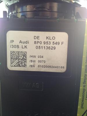

Thumbs up 2006 Audi A3 - Electrical Issues - HELP!!!!
Thanks guys...
Attached is a picture of the module and P/N if this helps.
Attached Thumbnails 2006 Audi A3 - Electrical Issues - HELP!!!!-img_1648.jpg
Old Jan 9, 2014 | 12:22 PM
Jeff-AudiUSAParts's Avatar
Former Sponsor
Joined: Apr 2011
Posts: 511
From: Beaverton Oregon
That is called electronic module for steering column combination switch. P/n you gave is good and the most up to date, retail for 418.00, your price 336.91 plus 10-12 dollars shipping and takes 3 days to get to us first. Thank you for the number, that made it much easier. There is no sales history on it from us, we either never sold it, or never sold it in the last 3 years or so. Stock in Audi warehouses across the nation tells me it's not a hot seller in the US either. Of course this doesn't mean yours is not bad.
