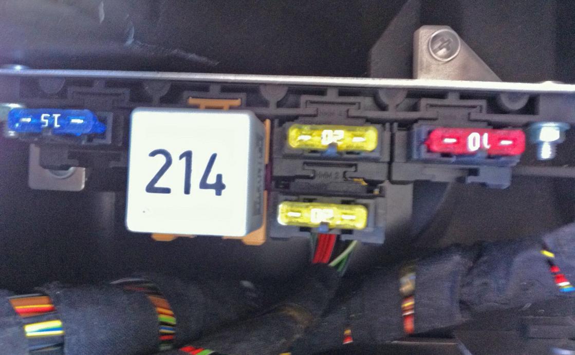

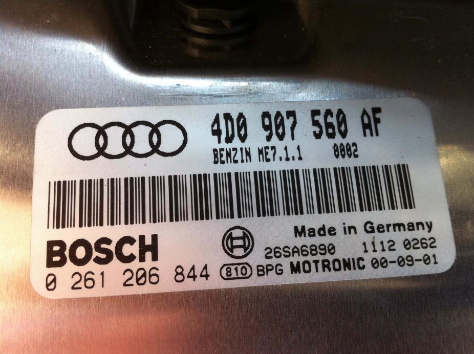

The more critical problem, after the reversed battery cables, is that the CMU, the car computer is not communicating with a scanner that used to read codes for everything. I replaced both catalytic convertors and all oxygen sensors and get no reading from the CMU for that or any thing else. In the watertight case, in the plenum area, the CMU has a fuse bus with four fuses and a relay(I think) all the fuses are ok but the CMU????
Are there any more fuses that protect the CMU somewhere? Is there a way to test CMU independent of the scanner plug under the steering wheel? Attached is a picture of the CMU and fuse bus. Assuming the worst that I shorted out, will any Audi dealership repair facility be able to tell how the CMU was damaged? Is there any way for them to do forensic probing of the CMU or will it simply be a unit that malfunctioned, cause unknown?
