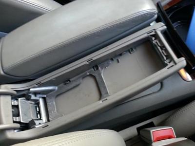

Phone see's car but wont pair.
In the armrest where a phone cradle should be is missing. Can see a loom going up to the armrest but not inside the armrest?
Any ideas please

1 Fault Found
02387 - Telephone Mount (R126)
011 - Open Circuit
