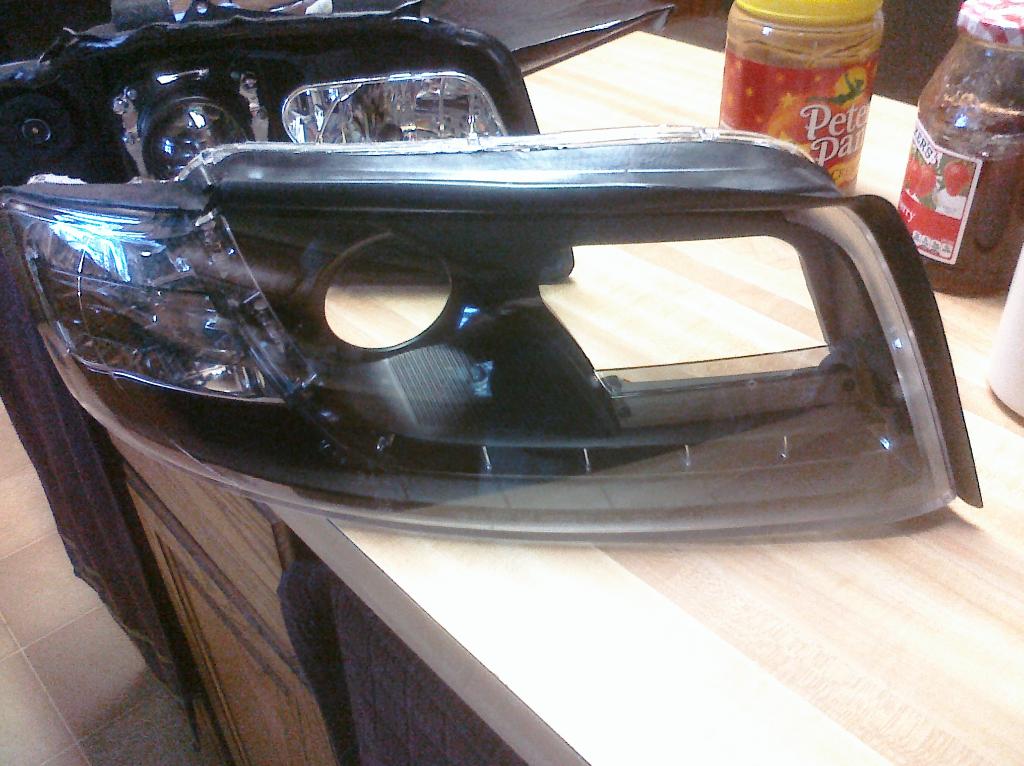

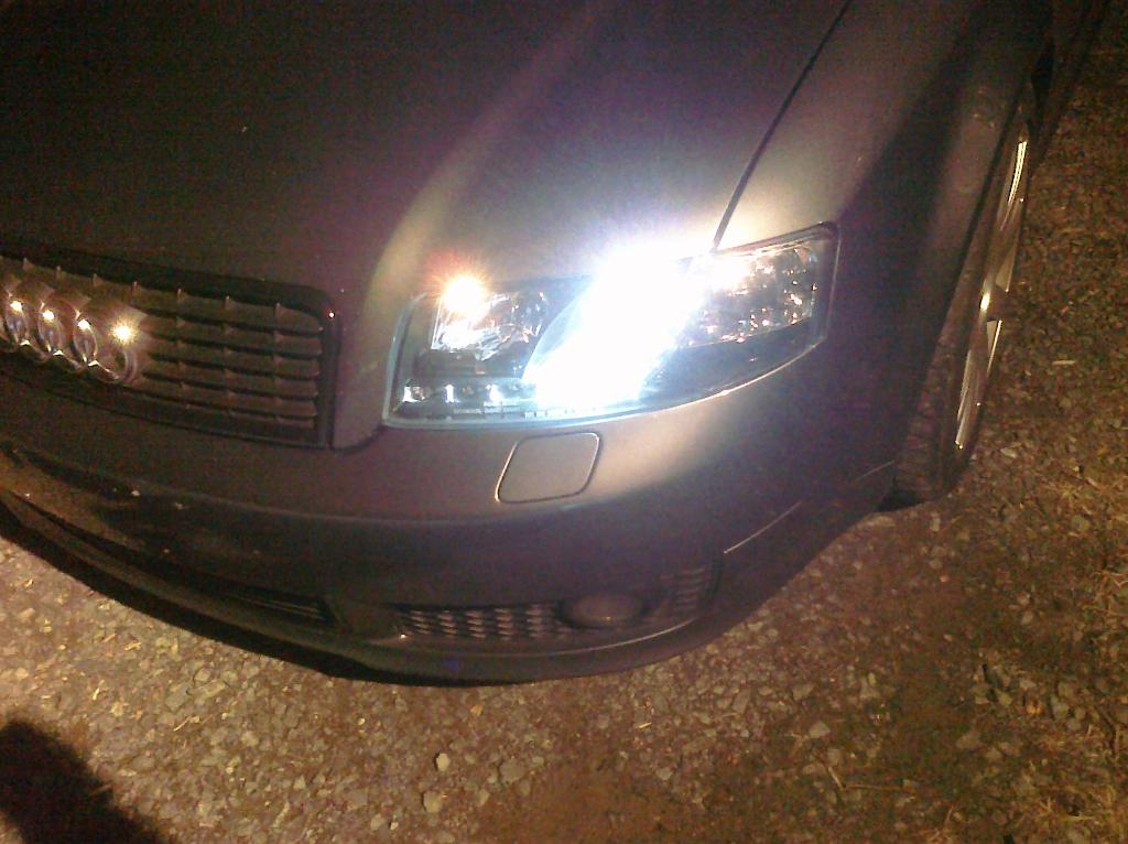

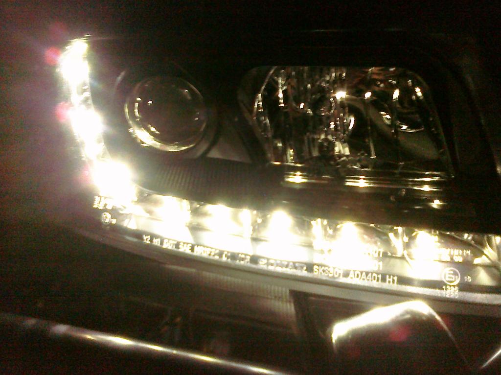

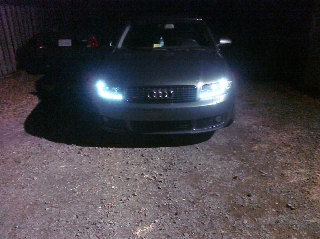

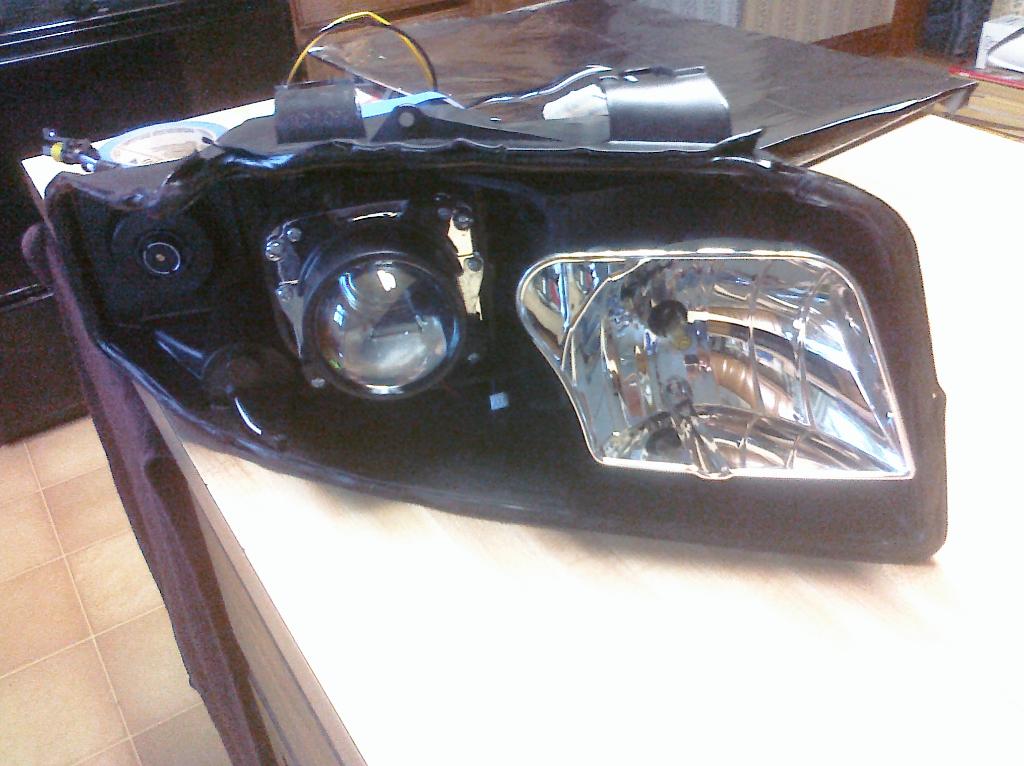

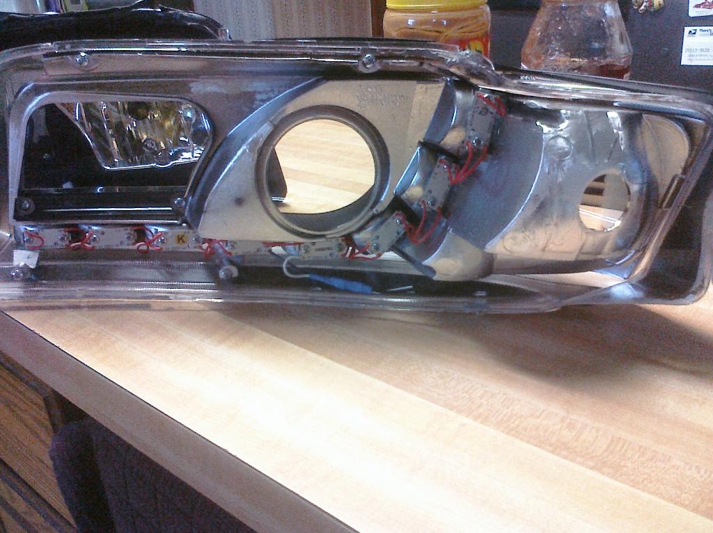

Whatever sealant they used is pretty high temp. In the oven I was melting the plastic housings before sealant was coming free. Didn't want to push it so I warmed them to about 200 degrees then took a heat gun and pain painstakingly had to free them bit by bit.
Used the D2S 2.0 bixenons, huge improvement over the frankly sad stock HID's, put in some rally yellow for halogens highs and up'd the LED's. Now there as bright or brighter then OEM's.
Limited pics, but you get the idea. On HIDplanet I'm BHRpowered (The extreme Q45 retro guy)

Begins

Final product. Ultra razor sharp cutoff, good color, proper ECE design, LED's matching HID's perfectly with good intensity all coming together for a menacing S5 style reflection

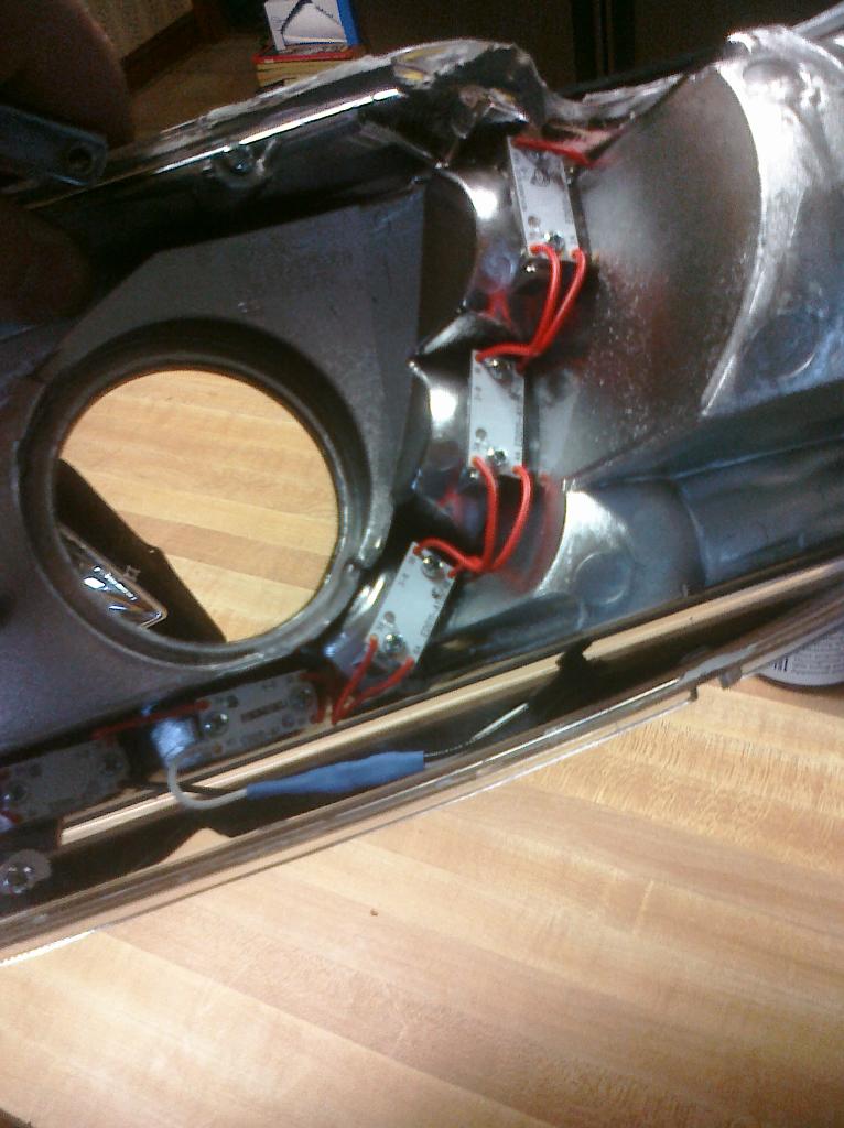

What did you have to do to up the brightness on the LEDs? I have the same headlight assembly on my 2004 A4. I just bought my HID fog lights at HID Kit, HID Conversion Kit, HID Headlight Kit for Cars & Trucks at HIDNation.com
Reply
Mar 7, 2013 | 10:09 AM
Pretty easy, just remove the old and soder new ones in. I actually went to advance auto nad got a strip of the extremebright or something strips and took from them. You can go online almost anywhere and get replacements with a lumen rating equal to OEM ones.
