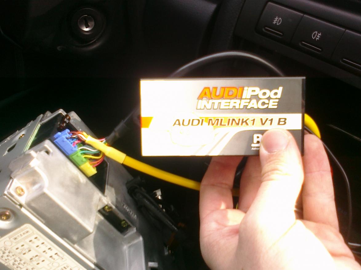

HOW-TO
You will need a Audi/VW radio removal tool. If you have the Symphony II, I think you will need 2 pair.
Remove the radio from the dash.
Connect the single ground wire from the Blitzsafe adapter to Radio chasis ground.
Disconnect the top harness connector, it's solid black and connect it to the red connector on the Blitzsafe interface.
Connect the blue/gren/yellow connector on the Blitzsafe to the spot where the black OEM connector was on the radio.
Then all you have to do is figure out where you want to run your ipod cable too, and connect your ipod.
Reinstall the radio and you're set to goo.
Attached Thumbnails Ipod Interface Installation: Blitzsafe-cimg0099.jpg
