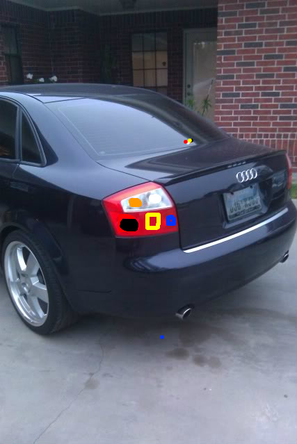

i have a 2002 audi a4 quattro, and was wondering if anyone has a wiring diagram of just the rear tail lights. i need to figure out my brakes and turn signals are mixed up and my reverse lights dont work at all, i have been searching the web for hours and am sick of shooting into the dark for answers.

best way i can explain it without a diagram. orange is turn signal. white is reverse light black is brake light dual filament bulb yellow is the driving light and the blue one is the fog light turned on by using the headlight **** and pulling it all the way out.

which one is the ground wire?
and thank you that should help.
should there be 6 those five and then the ground wire?
which color is that?
