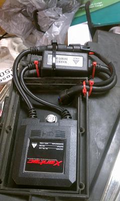

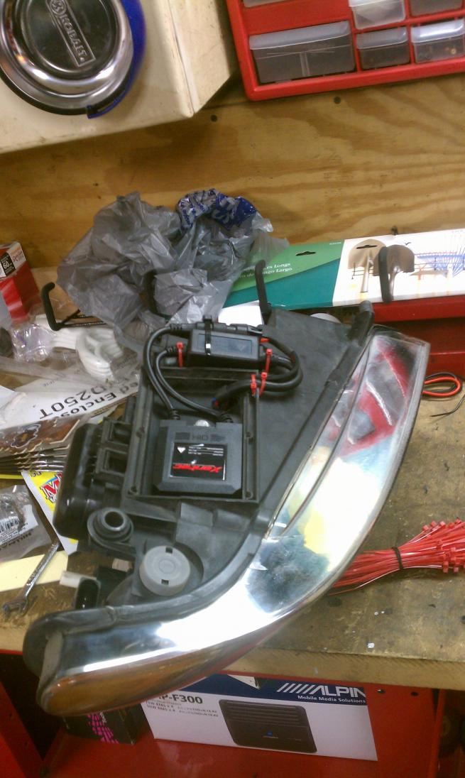

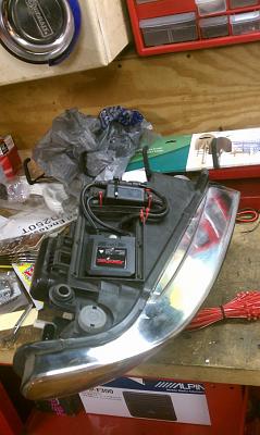

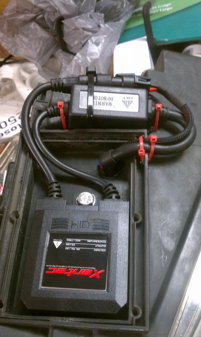

I installed the Xentec HID kit on my A4 B5 with very little problems. Just search Xentec on ebay and you'll find them. I think the kit with shipping was around $38 for me. I attached some pics of how I mounted the ballast under the headlight composites. Just unplug the factory headlight, plug it into the new ballast, and plug the other end into your new HID bulb.
