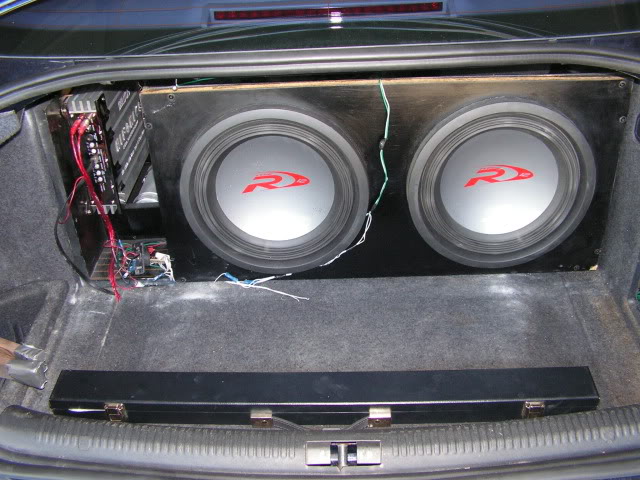

This is what sits behind that wall

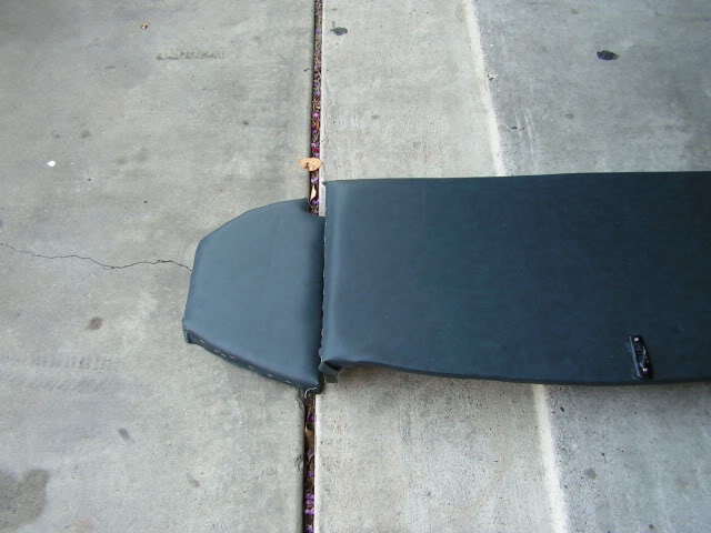

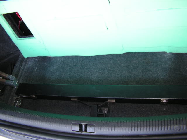

if u wanna get creative get a piece of sheetrock and build a frame around it. I had my old setup like that and it looked real nice. then go to a fabric store get sum cheap vinly or cloth or suede and upholster it. Mine use to be a frame around the subs but i play golf alot and one day my 9 iron almost ripped threw my speaker so i had to cover them as thats why my setup is the way it is now. I also have my pool cues underneath the floor so i have storage still. Plus it all comes out inabout 30 seconds.

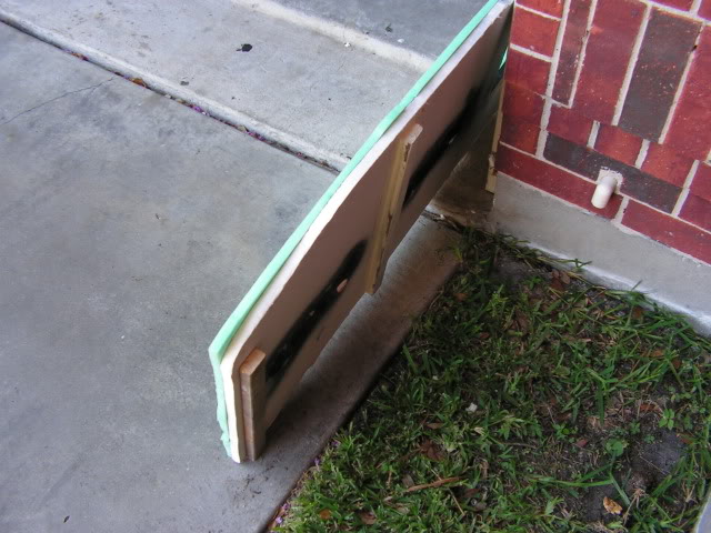

The wall is sheetrock and the floor is mdf as well as the little side cubby. i originally had plywood but its harder to get the contours of the top just right. So i bought a piece of sheetrock and cut it out with a skill saw and it made shaping it real easy. Then i taped up the edges got some foam to make it look soft and pulled the fabric over that and stapled it. Its been in there for about 4 months now and hasnt fallen apart yet. Plus its way lighter and it all comes out in about 30 seconds. if u do plan on doing something like this make sure to leave a few inches between the wall and the subs or u will get a loud vibration. I should post pics on how it goes in comes out.
heres a pic from the back. Name:  PICT0195.jpg
