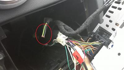

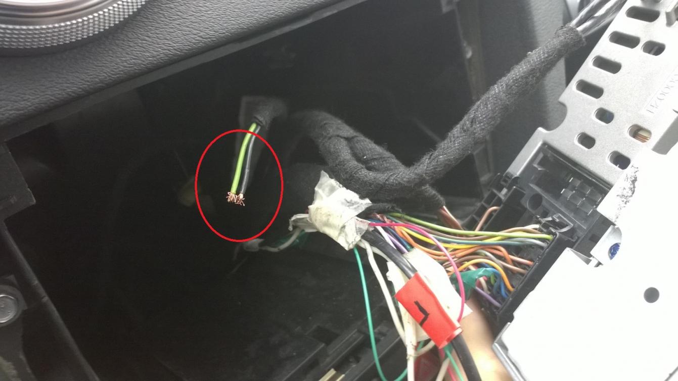

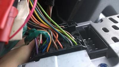

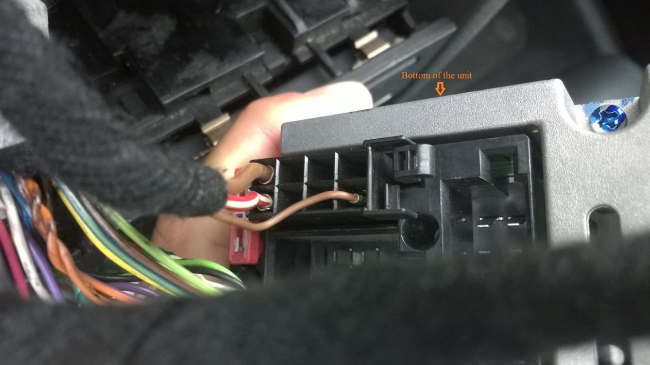

Presumingly there is something wrong with the wiring that I had not interfered with (except I connected aux-in via SAT button). I attached a couple of photos how the wiring looks like from the back of my HU.
What worries me is that there are two extra wires which are not connected to anywhere (Green and Black).
By searching through the forums I only found a information how to change Symphony II HU to RNS-E which did not provide any information on how the wiring for OEM bluetooth should look like, maybe those two extra wires are the key to this (?).
There is an empty connector slot (4 photo, top slot) which according to a wiring scheme should have tel + tel- nad mute connected. But there is nothing connected and mute, and line-out (caller hears me) works perfectly so it must be something else.
