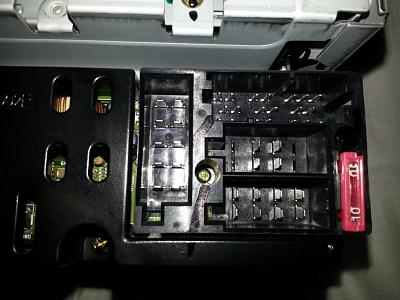

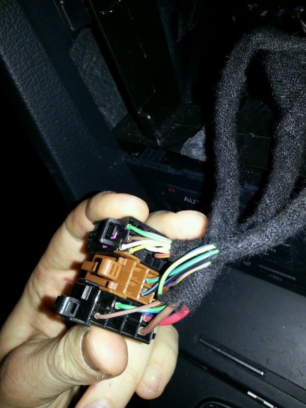

Hello,
I have an Audi A4 3.0 Cabriolet from 2004, B6 model and an aftermarket JVC radio that I would like to integrate.
To integrate the radio, I need a wiring harness to adapt the car wires to the JVC Radio.
In order to choose the correct wiring harness, I need to know whether my original radio is BOSE or non-BOSE and whether it is half or fully amplified.
Could you please let me know how can I know that?
My original radio model is: "8e0 035 195 M".
I have attached the pictures of the connectors of the car in case that helps.
Thank you,
Jon Murua

I 100% confirm that your vehicle come with BOSE sound system.
And it is half amplified.
Please feel free to contact me if you have any questions!

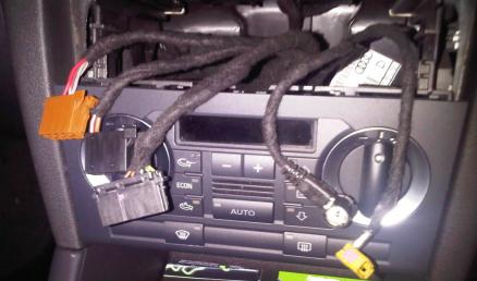

I have Audi A3, 2006, 2.0TDI 8PA Sportsback, can you please also tell me if mine is bose/non bose, and which amplified etc?
picture attached
