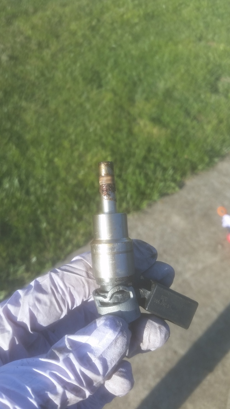

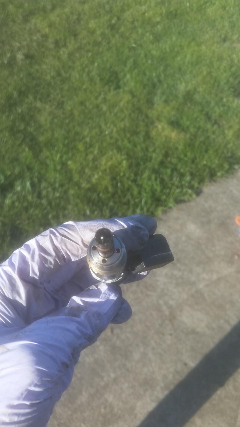

Sorry for the long delay. It took a while for the parts to get here and then it was too miserable outside to work. I got the fuel injector in but unfortunately I accidentally snapped the connection for the hose to the coolant overflow (a pretty pricey mistake). Anyway, here's some pictures of the old fuel injector. You can see a large build up on the fuel injector, the others had a little oil on them but nothing like this one. This makes me feel better about my theory that it was the issue. I won't be able to test it until my upper radiator hose comes in but I'll keep you posted.

So I still have a misfire on cylinder 3. I'm kind of at a loss. The PCV seems fine, there was a small amount of oil in the intercooler tube but that's normal. Ignition coil and plug swapped, and a new injector. What's next?
