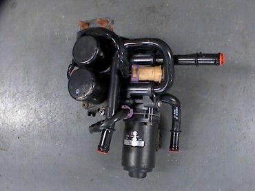

Taking a picture proved difficult because it is buried so deep. I found the attached on the net.
The cylindrical unit at "6 o'clock" is what I believe is the circulating pump and is what was making the noise and what I have disconnected.
The two upright cylinders at "9 o'clock" each have an electrical feed and remain plugged in. (the beige plug is what feeds them)
Any conformation would be appreciated.

Yes it does look like it has the heat valves are attached. But if they are on a different connector you should be good. You will probably experience heat that is not as hot as it should be.
