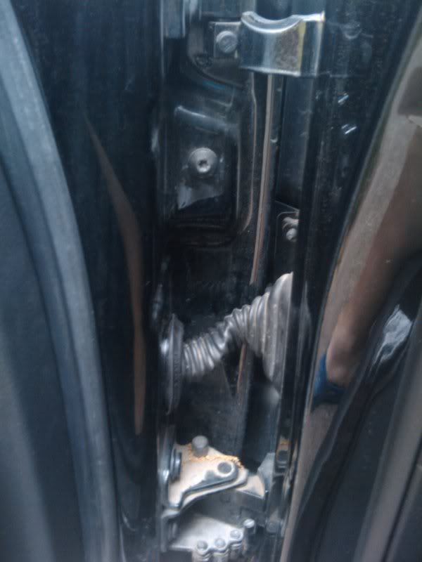

I checked into mine and found it like this:
is this normal? the boot is all twisted
