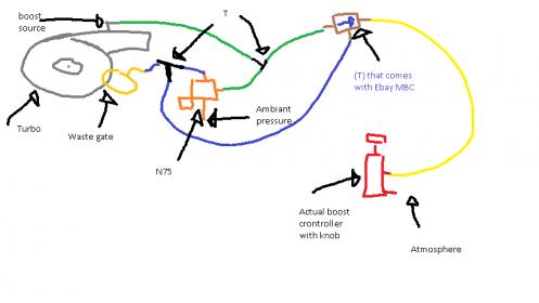

Ebay MBC wiring
Old Dec 13, 2012 | 03:41 PM
Jonh F.'s Avatar
Joined: Dec 2012
Posts: 10
Default Ebay MBC wiring
Ive seen alot of people trying to figure out how to run the N75 with Ebay bleed style MBC's and ive seen alot of rightups but theres always someone asking about the (t) with the spring and ball in it that goes before the MBC ****. So i got on paint and draw a simple wiring for myself and im just sharing with future people who needs this information. I give all permission to use this amazing peice of art for further uses.
