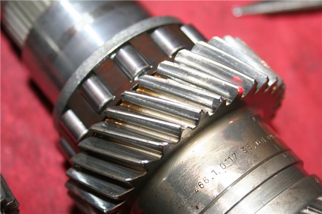

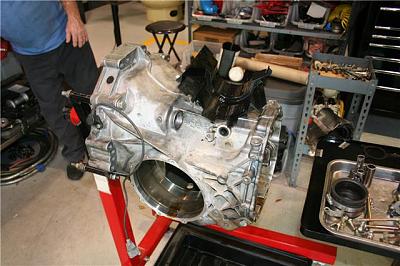

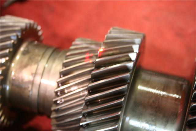

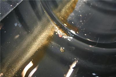

Hey apsbainc. Unfortunately my problem ended up being a bit bigger than expected :/ I first took it to braman audi here in so. fla. And they said that a new clutch would fix it. So i told them that if they were absolutely sure, to go ahead and do it. Turns out it did not help at all!!! So I took the car out of there, never to take it back there again!! I then brought it to tuners mall down in coral springs. Ther are absolutely wonderful and seem to be very honest. They took pictures of everything they did and sent it to me, as well as explained everything and made sure it was ok to go ahead. So they took apart the tranny, and happens to be that the teeth on most of the gears were very worn out and even chipped. The synchros were also bad, and one of them even fused together, not exactly sure what he said about that.. I'm not too knowledgable when it comes to trannys . I ended up having to order a new transmission from Germany so you can only imagine the price of everything in the end. My warranty had already ended so I had to pay myself..at least this new tranny has a 12000 miles, 1 year warranty, better than nothing. Now the car is as good as new though. I think the only way for you yo find out for sure is to take the tranny apart..sometimes its hard to tell any other way.. unfortunately transmission work is super expensive hopefully tomorrow I will post the pictures of my old tranmission and its internals so you can take a look at it. I should be able to post them by tomorrow afternoon. Good luck with your Audi!

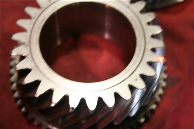

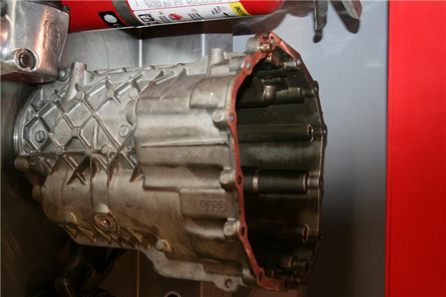

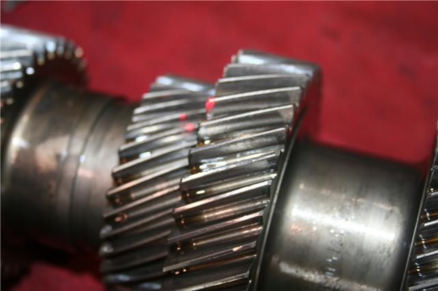

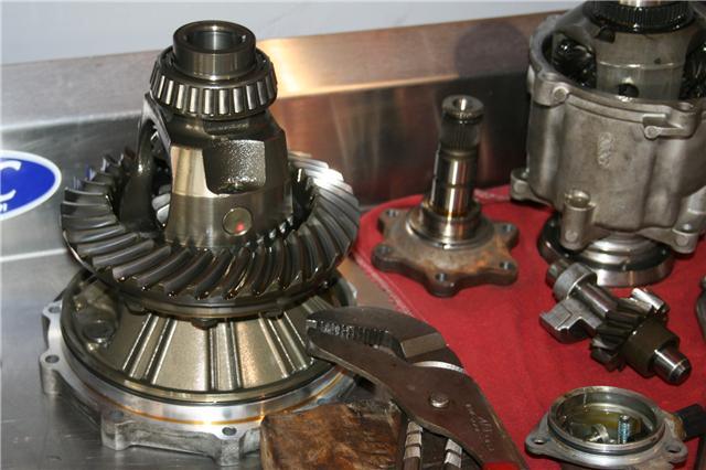

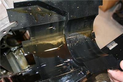

here are some of the pics...i am uploading the rest...sorry for the delay. i couldn't get to it earlier.

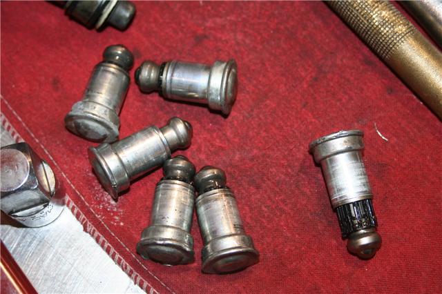

here are some more

that's all of them that i recieved from the folks over at TuneRS Mall. Seems like a very arduous task. Hopefully you have all the necessary tools and equipment to work on it. Makes things much easier!
