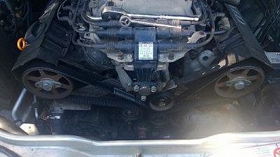

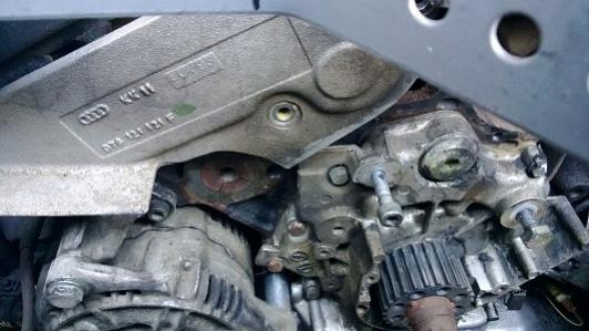

Hey fellas.. I'm changing out my TB/water pump due to a bad water pump (well, actually a busted bolt from the last gorrilla to change it). Taking off the TB tensioner. I noticed it was directly bolted to the block. There is no hydraulic system. Just a pulley.??
Any ideas?
Why do some pics show a tensioner like this one:
http://www.happywrenching.com/audi/a...ing-parts.html
... if its just a 'tighten and go' pulley only system?? I see empty bolt holes too.. ??
Thanks.

A couple of pic of the situation.. before I removed the TB, and after I removed the pulley. It goes where the long bolt is..
The tensioner is spring loaded. You will see a pin that needs to be pulled on the new one after you get it all installed and the belt put on.

I already have a 'new' one.. it is just a pulley... no pin. In the link I posted, there I do not have numbers 3 and 4. They were not on the car when I took it apart.. ??
