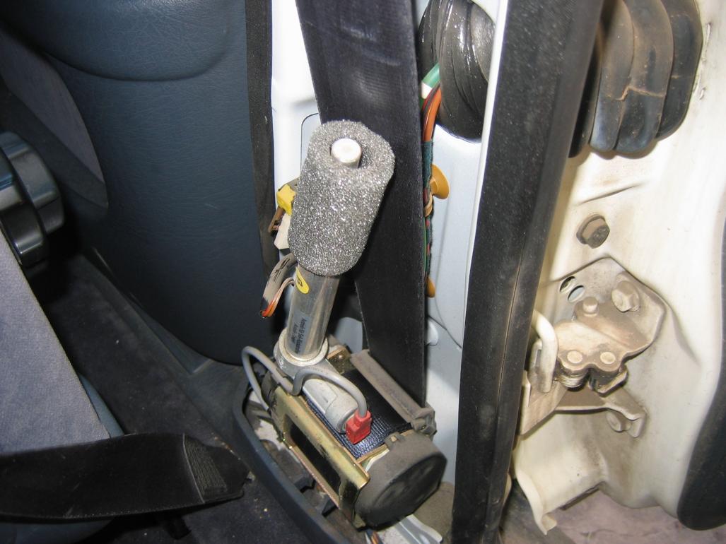

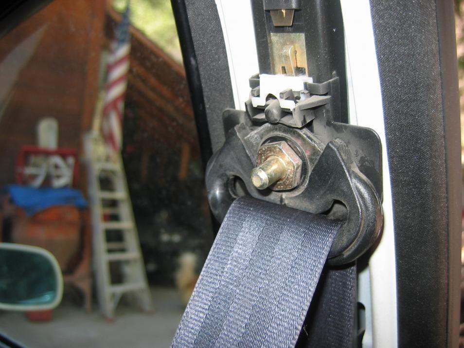

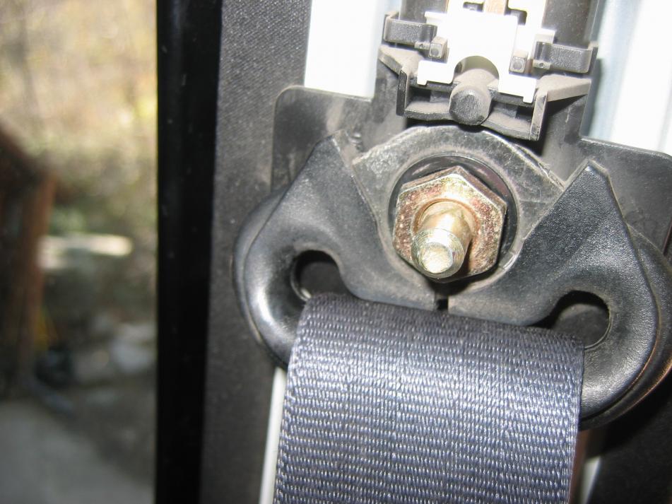

Got into the passenger side seatbelt retractor today and found the actual unit to function just fine! This ONLY happens, however, when I create some slack between the B-pillar attachment point and the retractor unit down by the floor. Otherwise, the retraction is slow as molasses! I detached the B-pillar loop from the pillar and played with it a bit and was able to get the belt to operate properly when I, by hand, angle that loop just enough so that it doesn't bind against the belt (I think that binding action is designed that way so that the belt, when it was new, retracted just fine). My suspicion is that the belt has aged by thickening and becoming less flexible (just like me!) and that if I can create a shim that'll replicated that non-binding angle and/or open up the slot that the belt courses throught, I might solve the problem. I also tried spraying a Teflon-based lubricant on the contact areas but with no joy. See the attached pics and I welcome any thoughts/ideas.

Okay, last night I wrestled and wrestled with re-coiling/winding the retractor, which is really challenging, trying to hold it all together and keep it from exploding or unravelling. Got 'er done and tried it out but no joy. The only thing that really seems to work is angling that belt buckle on the "B-pillar" to such a degree that it does not bind/restrict the retraction of the belt. Therefore, I'm going to try to fabricate an angled spacker for that buckle to replicate the proper alignment that'll make all this happen. Hey, if there's enough of you out there and this works, maybe I'll market it and make my first million!!!! Not!!! Stand by. . .
