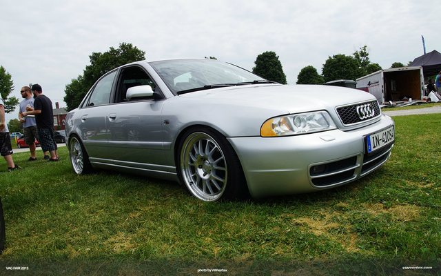

Go k04s, fueling, open intake, turbo back
Well over 400hp, daily drive-able
I did mine last year and i promise you, do it right and you will love the car.
