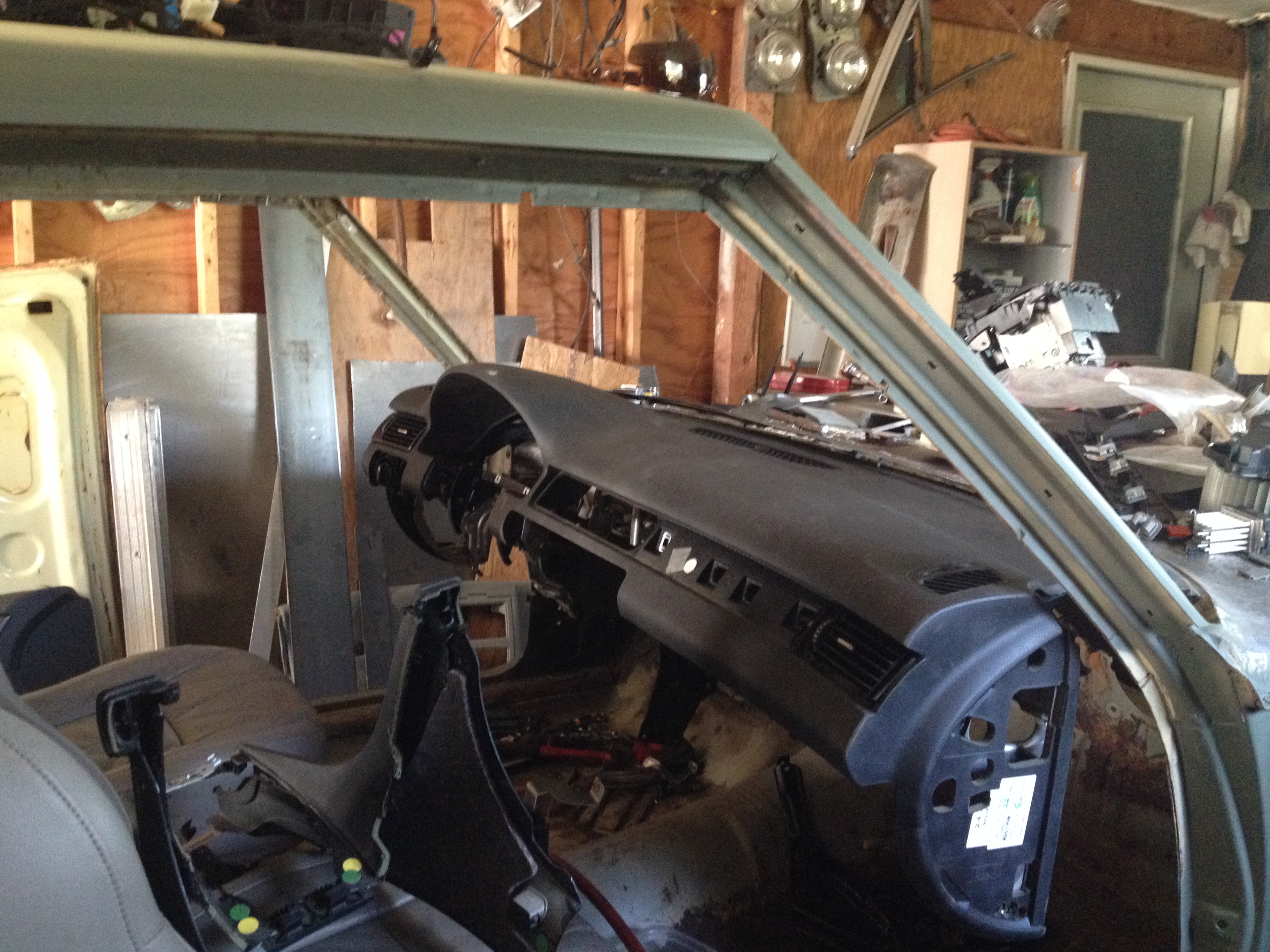

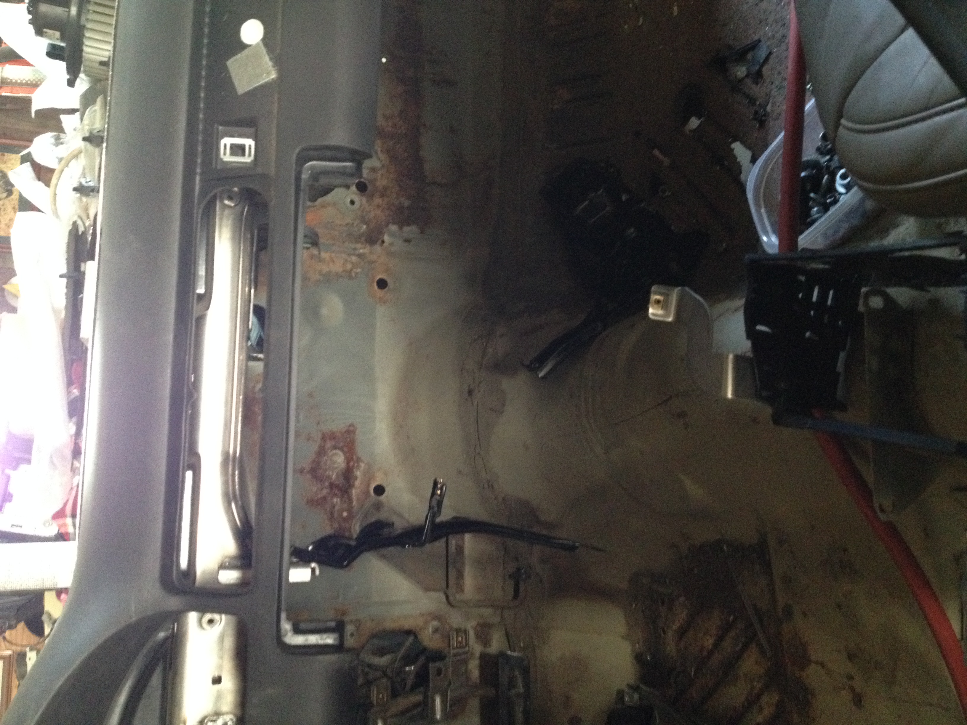

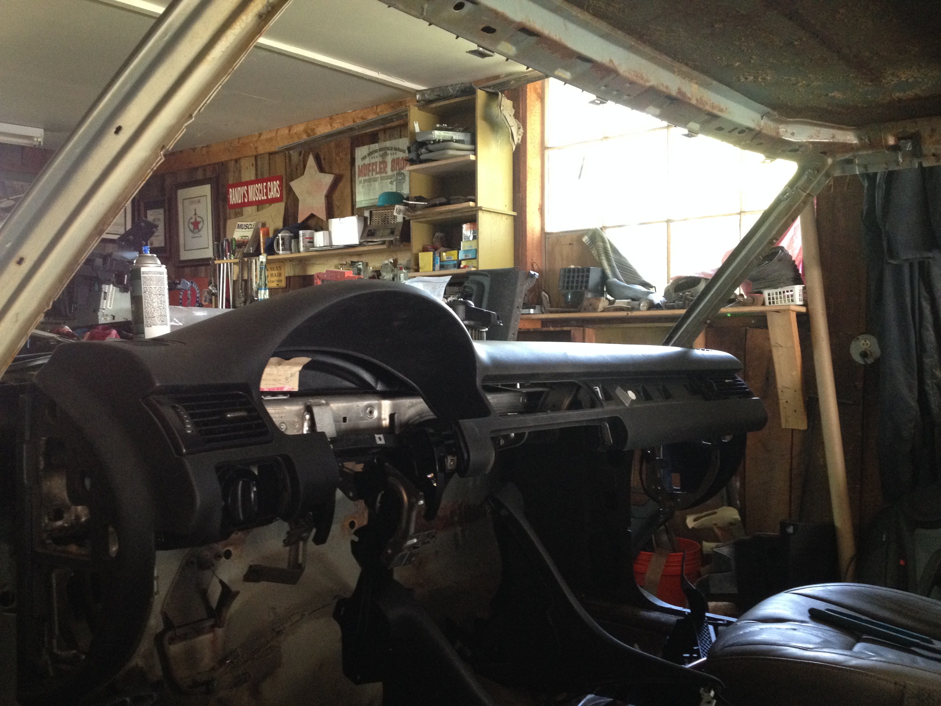

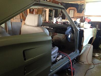

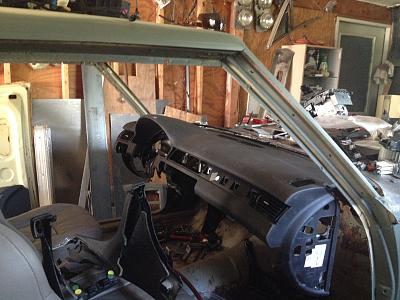

Hi all, I need help installing the dash center tower that holds radio and hvac behind it. Im installing a 2001 Audi Allroad Quattro interior in my 1967 Coronet street machine build. I could use factory pics of the way the tower framing goes together, the parts that hold the Symphony radio and hvac controls inside the tower. Thanks. I read a replace the heater core thread here and it was somewhat helpful but could really use some factory manual drawings/ schematics of the metal frames to either side of the radio tower under the plastic console tower shell. Thanks!

Thanks Julie, I pulled the heat and A/C today from the donor and the wiring harness. I removed the mounting bolt plates for the dash frame and will need to fabricate some brackets for them to attach to. I will also have to fabricate some extensions for the in and out tubes from the heater into the engine bay as the stock Audi ones would enter the bay right behind the right cylinder head. The fellas on the MOPAR forum think it will fly and so do I. Amazingly it looks quite at home in there.
