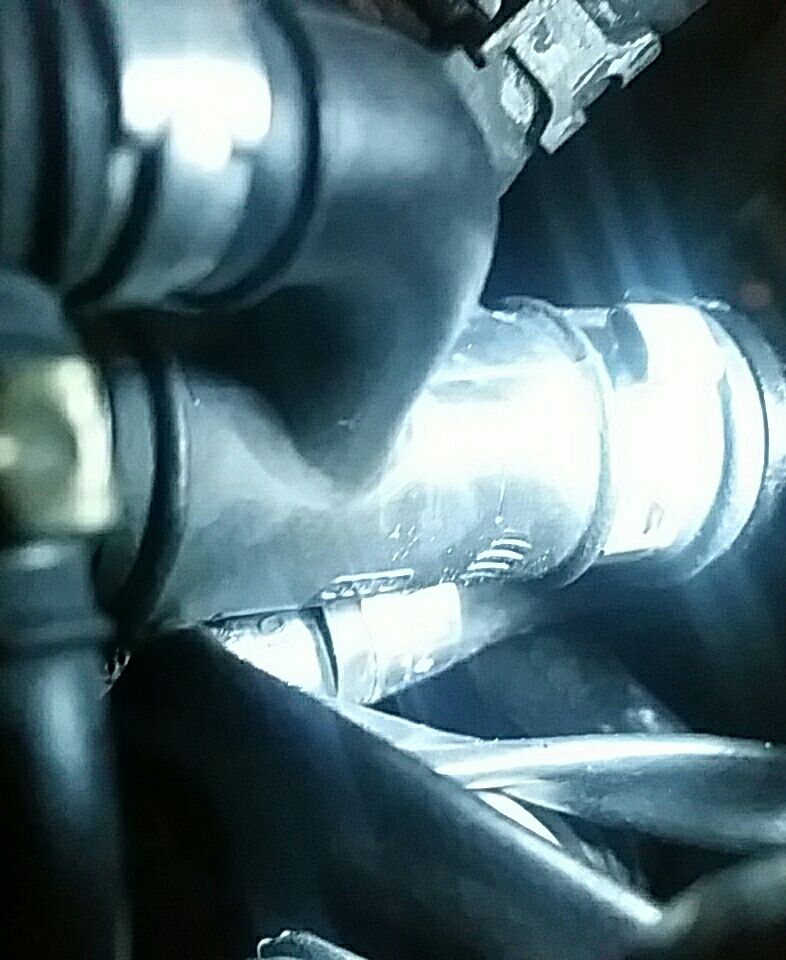

So ive been fiddling around with some hoses and noticed that one hose didnt even have a clamp on it, so i clamped it, and i look around where that hose was and noticed something off with one of the angled hoses. I think I found what that sound was coming from at the end of the hose it looks like slices. ill replace it and see what happens if that doesnt do anything ill do a leak test.
