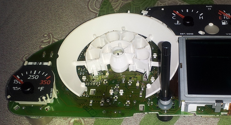

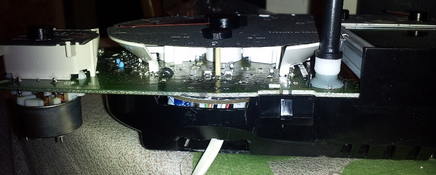

Inside the car I swapped in an instrument cluster with LCD display and the necessary wiper stalk with buttons, and of course replaced the LCD screen with a new one due to dead pixels. Also had the EEPROM which contains mileage information reset, so I could go into VAG-COM and recode the cluster's mileage to match my car's actual mileage.

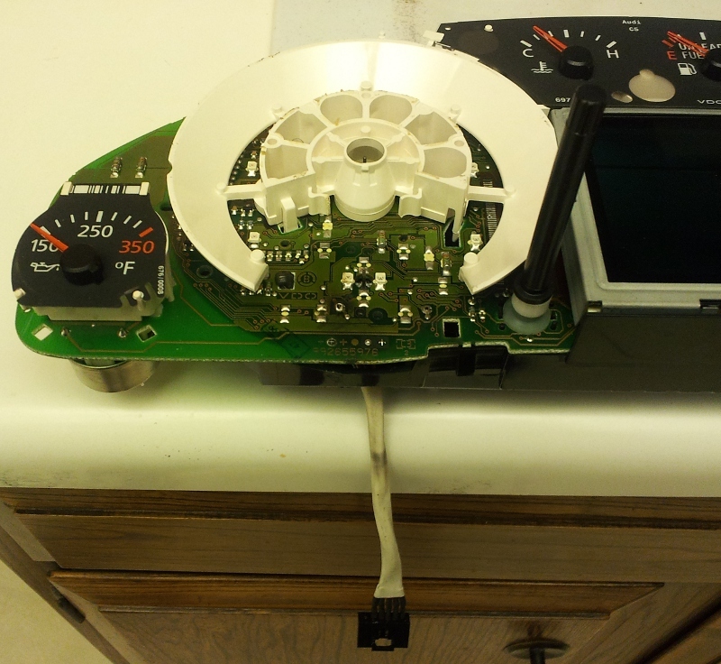

Also over this past weekend I retrofitted a Prosport oil pressure gauge in place of the analog clock in the instrument cluster, but it will still use the dial and minute-hand point from the analog clock (to match the rest of the cluster). So at 12 o'clock it will be 0psi oil pressure, 1 o'clock is 11psi, 2 o'clock is 22 psi, all the way to 9 o'clock which is 99-100psi. The oil pressure sender still has to be installed (have all the fittings ready to go), and wiring has to be completed. Hopefully it will work! Here are some pics:
Instrument cluster without analog clock:
Prosport Oil Pressure Gauge outside of its shell. Really doesn't take up much space!

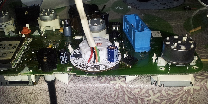

Removed connector from gauge's circuit board, and added wires in place. This will allow easy access to the connector for easier cluster removal in the future. Also shows the pressure gauge in place with RTV between the cluster and gauge (while it was drying).
Top (crappy) view of oil pressure gauge installed:
Putting stuff back together! The back shell required only slight trimming to clear the pressure gauge.

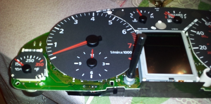

And a close-up showing how I made the original minute hand from the clock work with the pressure gauge:

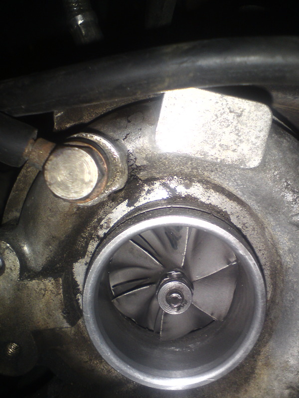

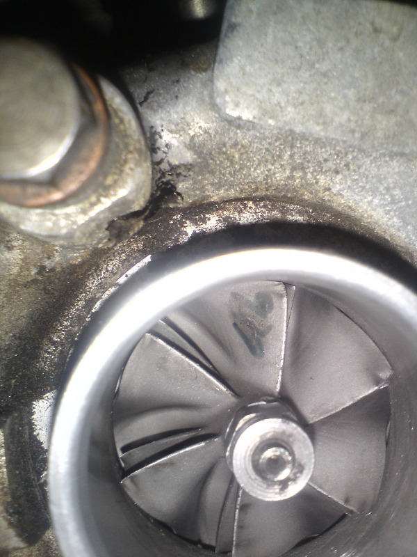

I boosted 30psi for a month and drove it like I stole it.. MY guess is that with this high boost in combination with a budget air filter the turbine was worned out or something like that... take a look for your self !
