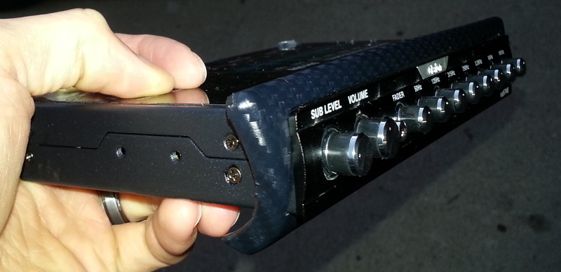

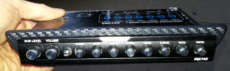

Today I managed to get the ash tray trim fitted to the equalizer, and figured out how to finally secure it in place of the ash tray. See the pictures

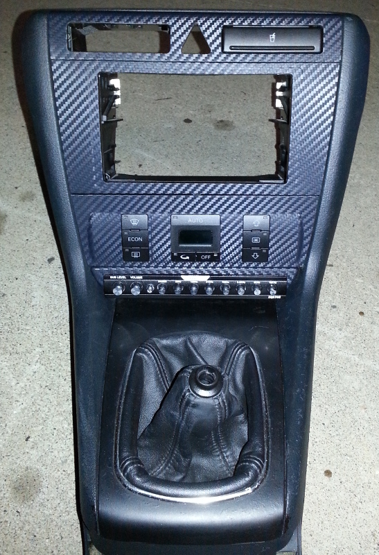

Spent my lunch break working at reassembling the center console. Got all of the front portion in so my shift boot back is finally back on and the HVAC controls have a proper mount lol.
You can also see the mess of audio wiring back there. It still has the connector for the old head unit. A previous owner did a mess of a job with wiring... butt connectors that were wrapped with electrical tape. Disgusting. Definitely going to rip all that crap out.

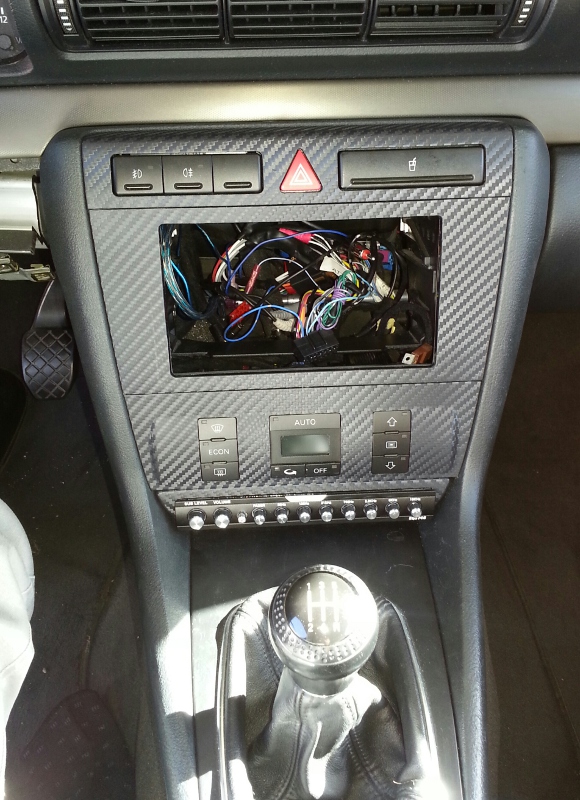

After staying up pretty darn late last night finishing/testing wiring for the new DC-DC regulators (adjusted to 5.35V each, and then put in parallel), and fitting the USB front-panel connector, etc., I was able to get everything put together
There's a pretty major hiss coming through the speakers which is independent of volume level or engine running, so I'm guessing the hiss is coming as a result of using the stock wiring and stock Bose amp. I may try to use a different ground, and/or buy a ground loop isolator to try to resolve this ASAP. It's quite annoying.

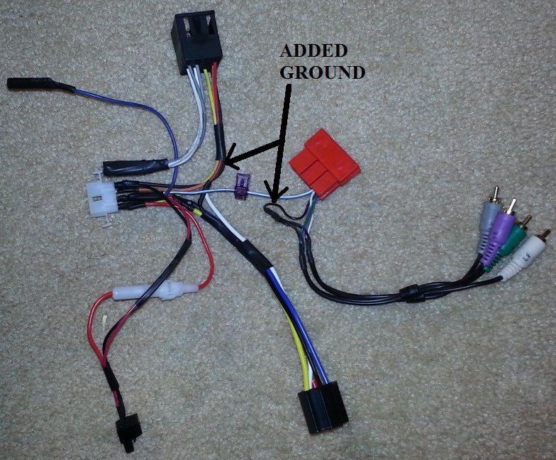

Between last night and today I spent a lot (definitely too much) time trying to figure out this damn ground loop issue.
Went through and grounded multiple points on my custom harness, including the RCAs that hook into the factory wiring leaded to the Bose amp, and the factory stereo ground wire. It's definitely much improved (bearable) but not where I'd like it to be.
After my efforts I've deemed that the slight alternator whine that's left is due to the stock Bose amp wiring, as I am currently unable to access that. So in the future since I plan to install my own amps and RCA cables I should be able to eliminate all ground loop/alternator whine noise.
Custom harness, before adding in the additional ground wires (but noted where they are):

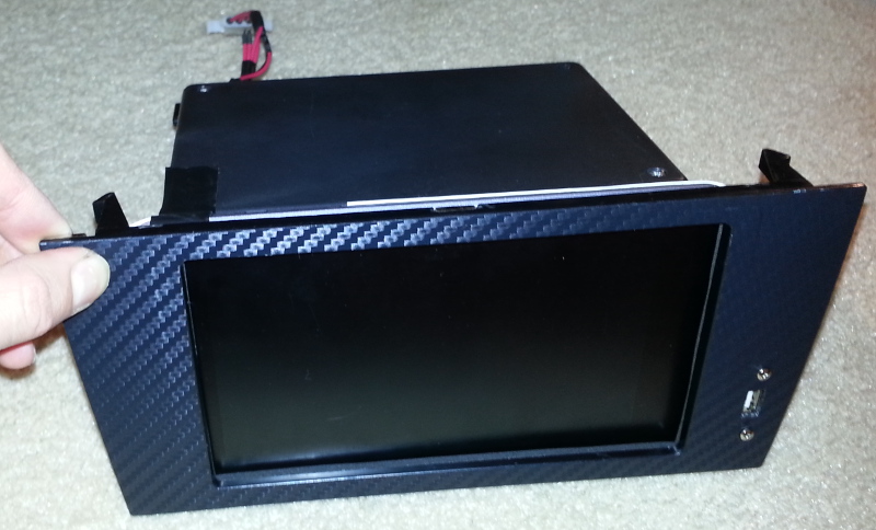

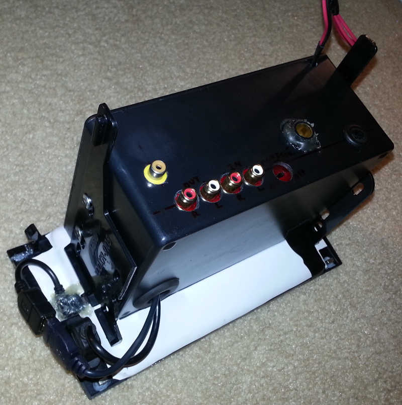

The "double-din box" and front fascia, including the tablet:

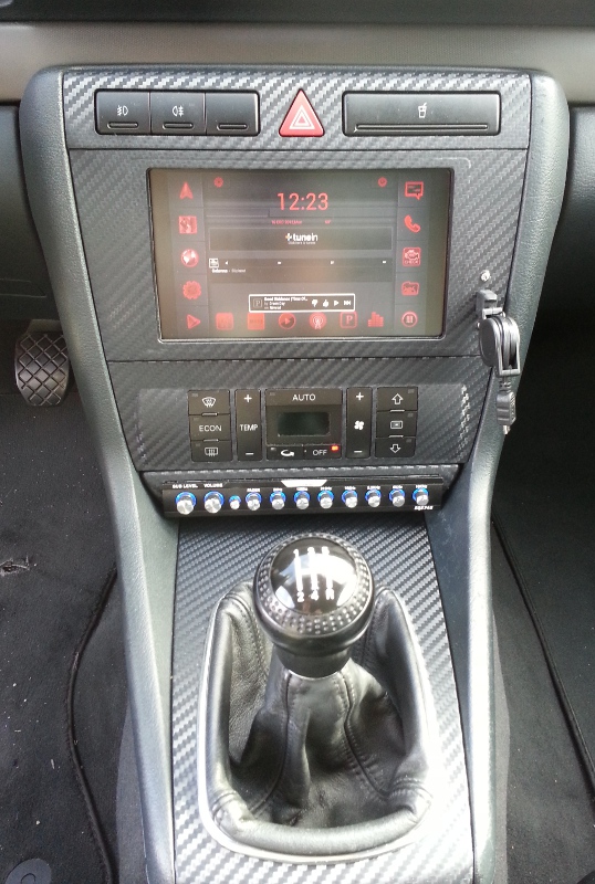

And this evening I wrapped the shift surround and the pocket that sits behind the cigarette lighter in 3M Di-Noc carbon fiber vinyl. No pics yet, but soon!
EDIT: finished pic

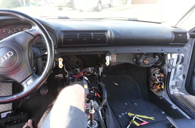

On another note, user "thepirate" motivated me to pull my dash beltline trim and finally wrap it in 3M DiNoc (to match my radio/HVAC/shifter plate). I only took a picture of everything removed, but I assure you the dash beltline trim is done and everything put back together
