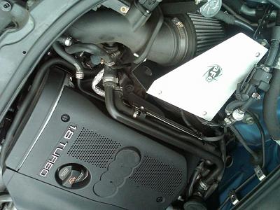

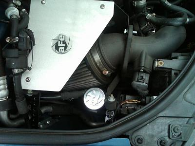

i found a hose by the intake wrapped with tape
and another by the engine wrapped in tin foil?
Attached Thumbnails please help!! code p0299 pending-img00068-20100529-1126.jpg   please help!! code p0299 pending-img00070-20100529-1128.jpg
