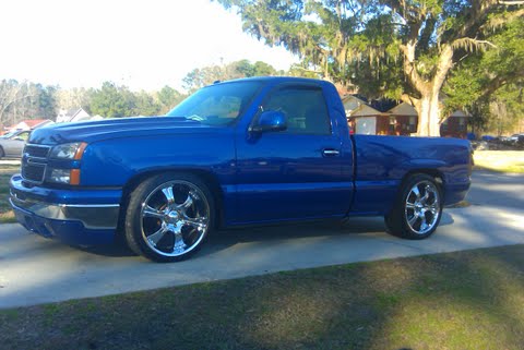

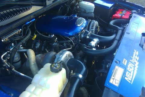

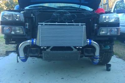

Hey man I am not trying to be a jackass, just use to being on other forums with a little more support. I replaced the bypass valves when I bought the car about a month ago along with the 034 motorsport tbb. I done alot of searching on the net and talked to alot of people with no luck. And I am not worried about being fast in this car, I bought it for a daily driver because it looked neat and seamed like a cool car. If you wanna ride in something fast and your ever in the ga area just give me a holla. 04 rcsb silverado, 5.3, cammed, t76 front mount 10psi dynos almost 500hp to the tires.
