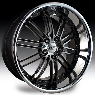

wanting to know if u think these wheels will need spacers to clear the s4 brakes. there 19x8 up front, 19x9.5 rear 35mm offset. also what size tires do i need to get?? was wanting 225/35 front, 235/35 rear if thats ok??????? thanks in advance. hp designs, wheel called to takeover 2's

9.5 wide sounds too big for 235s. Mine are 8.5 wide and I have 245s.

dont run two size wheels. AWD does not like it.

I had custom made 13 mm aluminum spacers needed for my 00 A6 to clear the claiper
