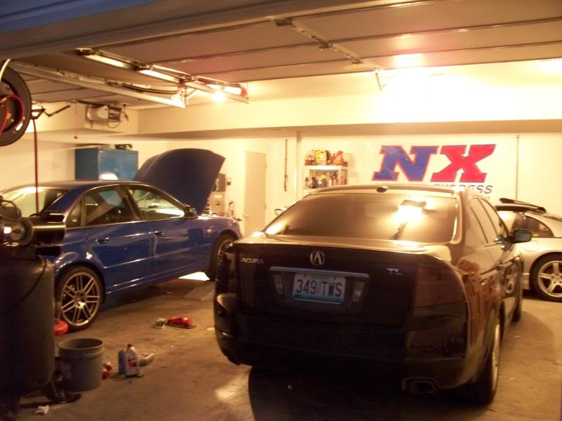

i would go with samco its like 64.99 or something compared to the 280+ bi-pipe and ive been hearing that alot of the bi-pipes have been cracking but damn kody car looks good with the rs4s you put on.....you need to make it up to one of the stl gtg's we might be having one the 16th
