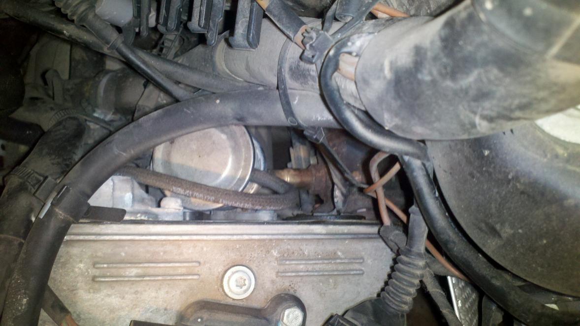

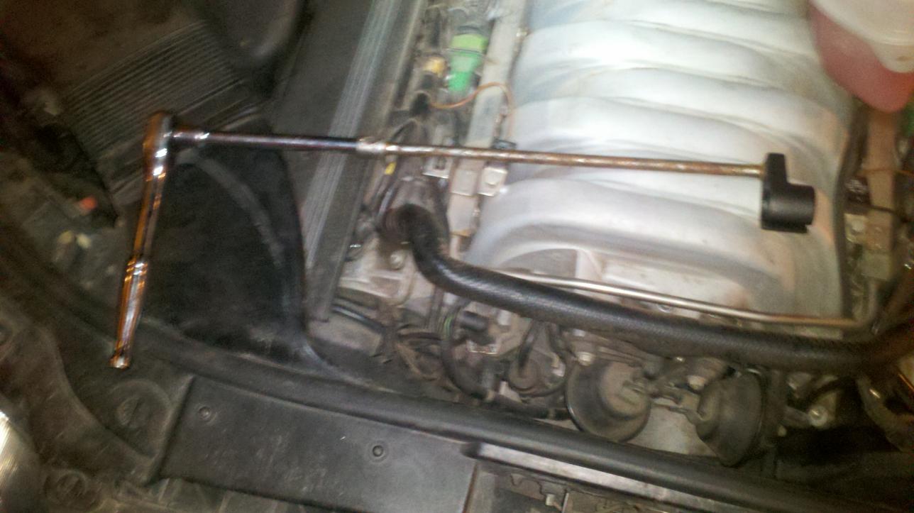

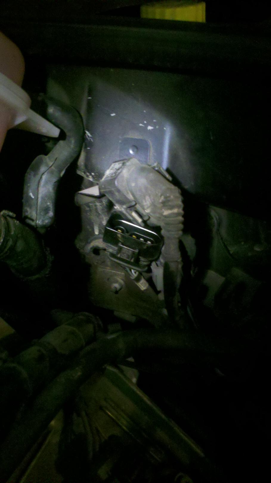

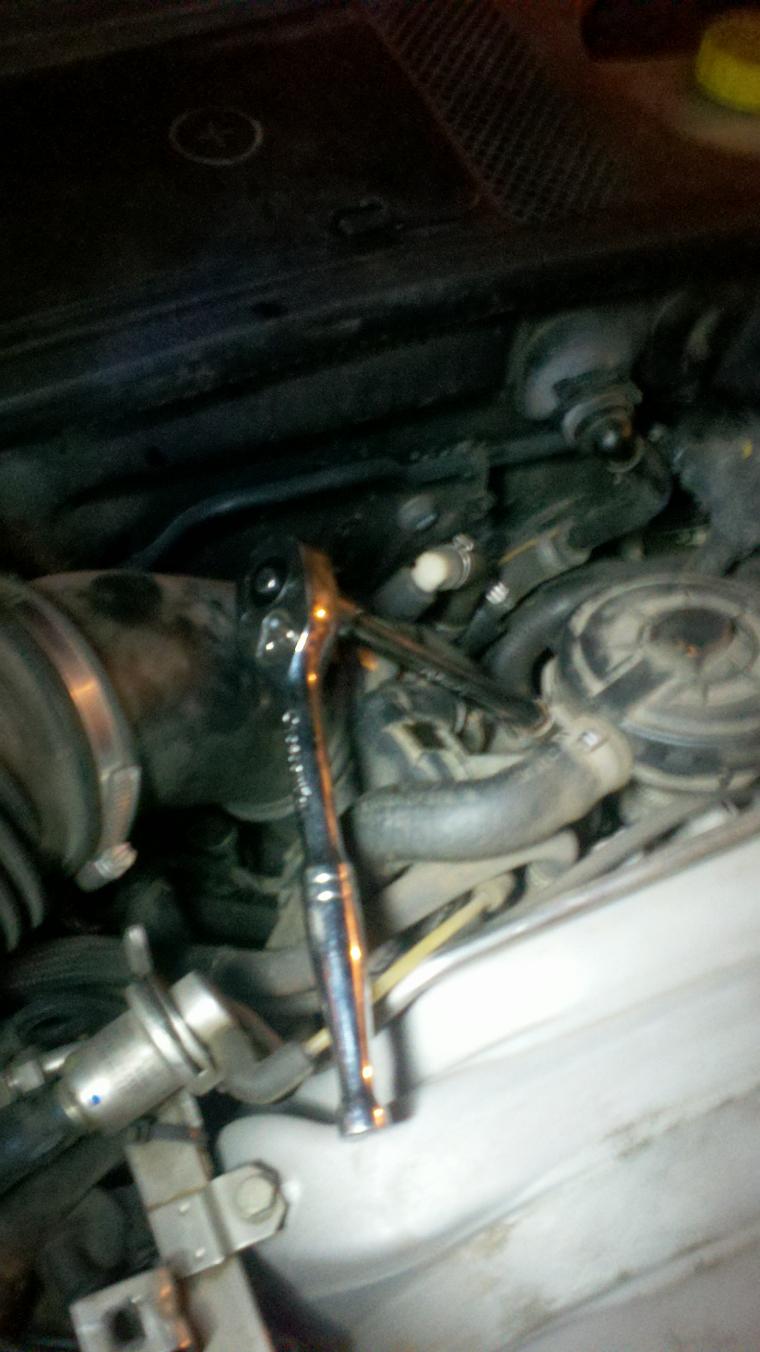

Got it swapped out. The sensor is easy to find once I removed the coolant overflow tank (see 1st pic). It was fairly easy to remove with the right tools. I put an offset O2 socket on the sensor then I could put an extension (actually 2 extensions: a 12" and a 6") into the socket from the top, turn with a ratchet and it was loose! The connector was right against the firewall and easy to access as well once the coolant tank was moved off to the side. Thanks for the help! The check engine light turned off on its own the second time I went for a drive--right about when the odometer hit a 100 mile increment--is this when the computer checks the sensors?
