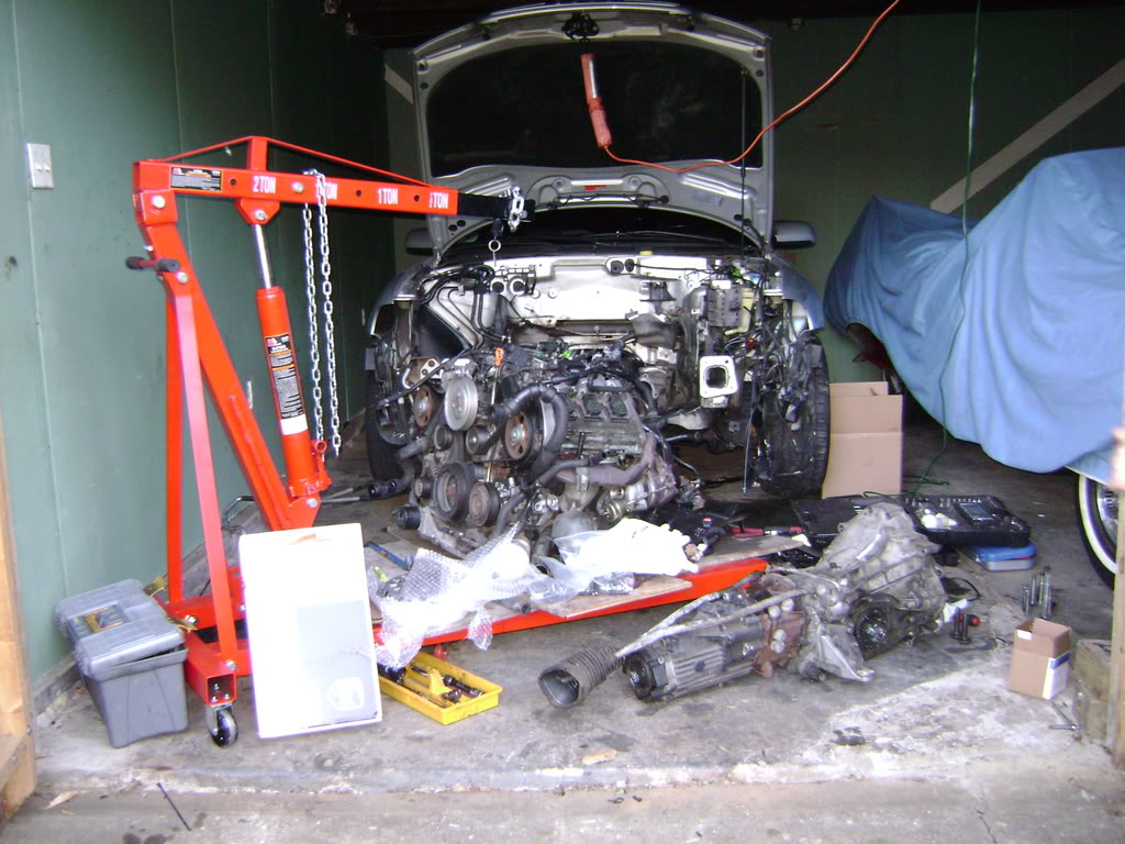

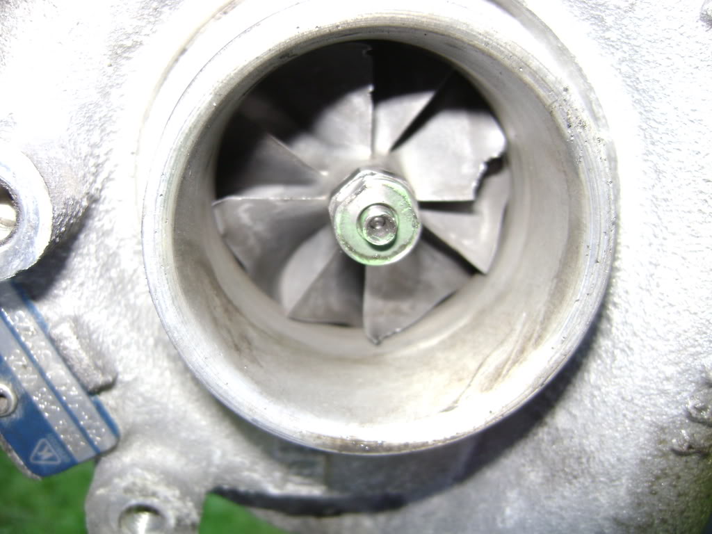

Last week I pulled my motor to swap out the headgaskets and slap in a new stage 3 clutch. After pulling off the lower passenger side inlet pipe, I quickly discovered that I had pwnt my turbo. It seems as though some sort of debris had made its way in there and dominated the fins of the turbo.
Here are some abbreviated pics of what we did and what we discovered.
Big ups to my buddy Clint for helping out. Guy knows his way arounds any motor.

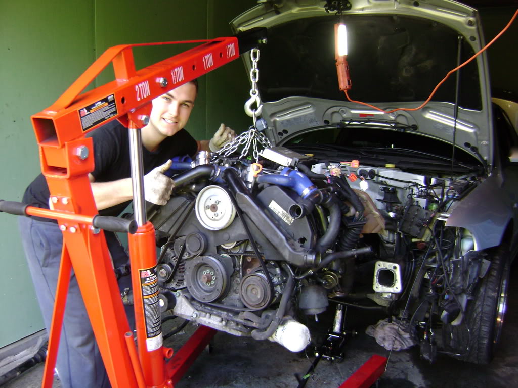

Motor and tranny out, ready to install the new Vast Stage 3 clutch

While getting ready to pull the head off of the car we pulled the inlet pipes off of the turbo and found this bad boy.

eek maybe thats why they look they way they do at 5k
